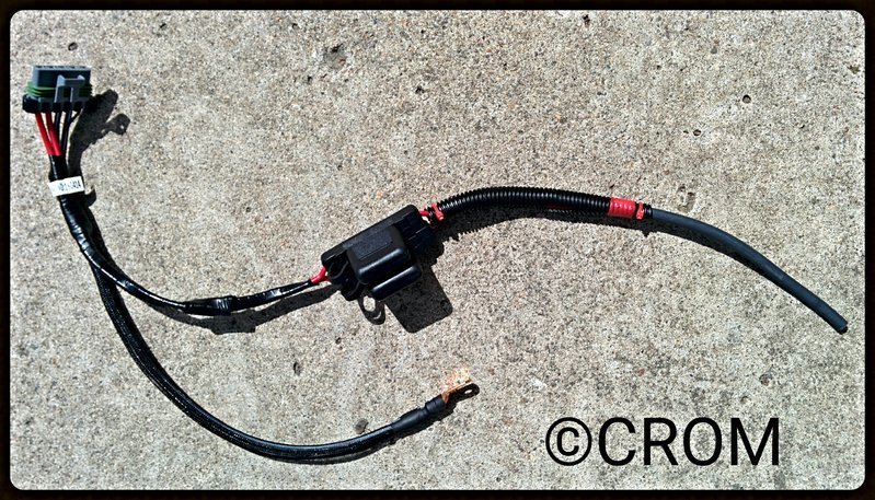

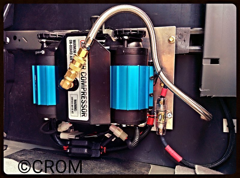

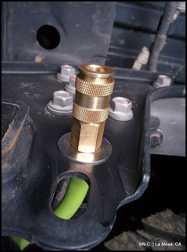

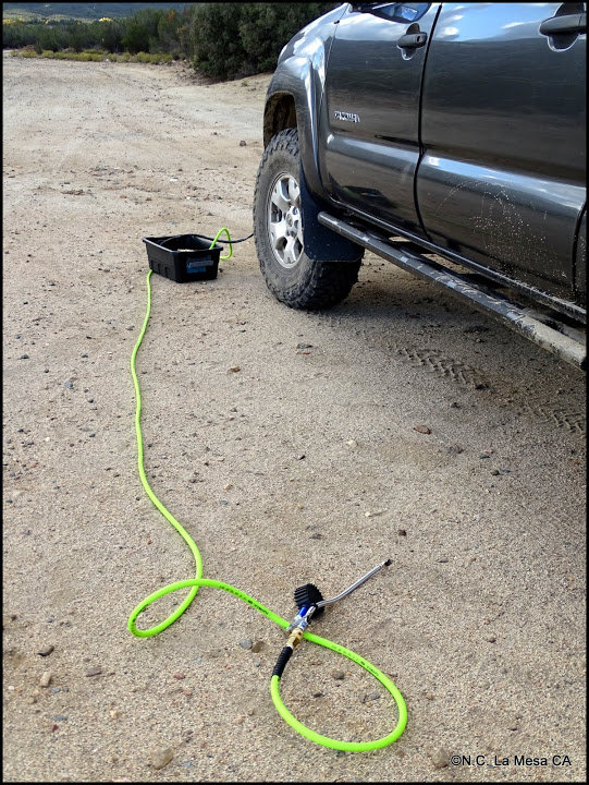

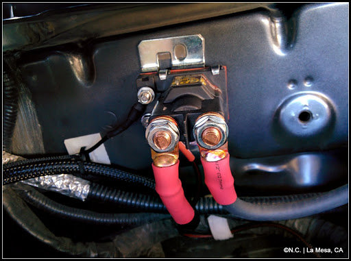

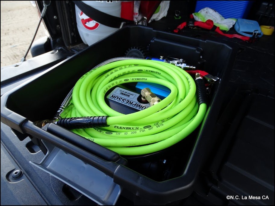

    The heart of my system. Twin ARB mounted to alum plate. Airline out the back wall, then 90*, tucks into frame rails, and terminated at hitch.
    MLV barrier over compressor.
    Custom wire harness. 4 AWG welding wires power.

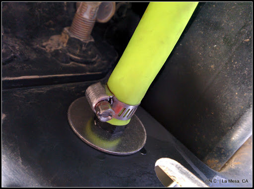

    Air line terminated in rear hitch.

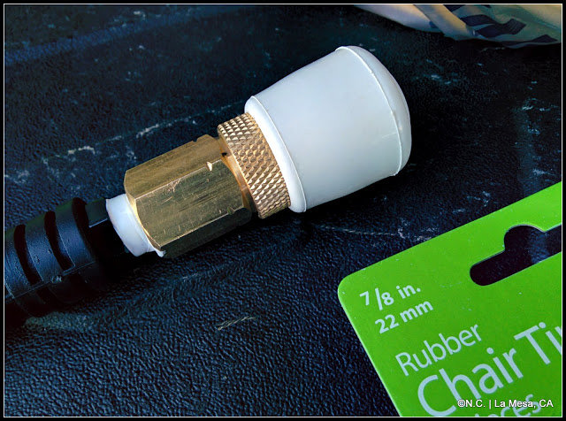

    The business end.
    Rubber chair end protects air fitting.

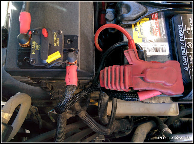

    Power
    Relay.

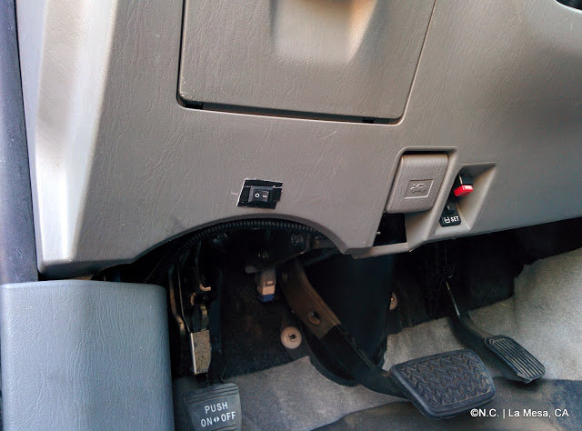

    I prefer this little black rectangular switch to the big ARB one. :)
    Fun project. Glad to be done with it.
    Lots of thanks to
    @MrGrimm , @AaronArf , @Nate87
    for sharing ideas, knowledge and experience.

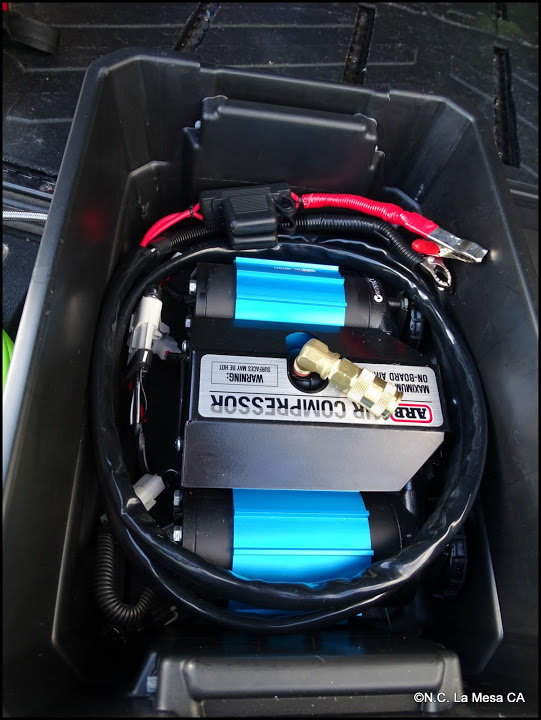

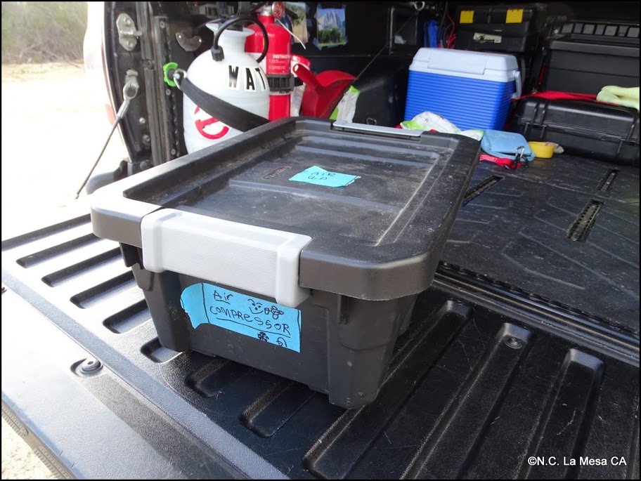

    I originally built my compressor into a portable system. I got tired of lugging a 20lb compressor around so I mounted it (pictured above).
    Portable System
    I got the dual ARB air compressor. I built it into a portable system.
    It kicks ass. Airs up my 33" tires from 20 PSI to 40 PSI, in 1 minute, 5 seconds.

    Yesterday I was airing up and the relative humidity was close to 90%. I can't believe the fu**ing amount of water in my air line. I'm thinking about employing a water separator at the end of my air hose.
