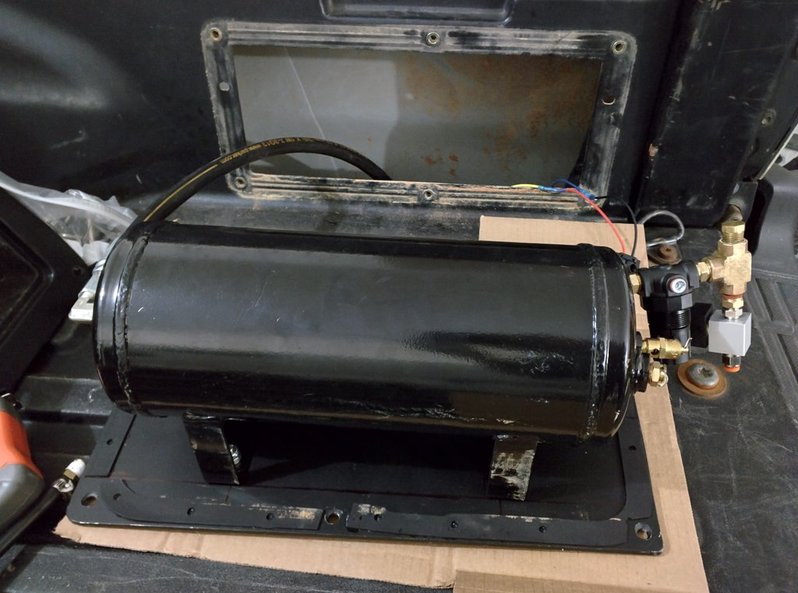

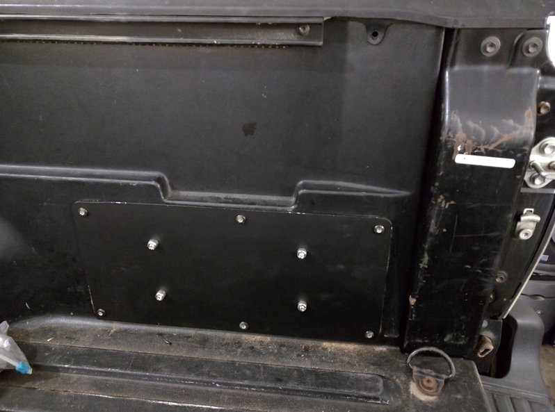

    Just like @THE CALICO did. Those 4 bolts above the cubby are holding the compressor to the other side of the composite bed hidden behind the fender.

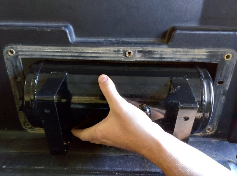

    I mounted a tank slightly bigger than that right under the pocket to the underside of the bed. That way I could still use the pocket.
