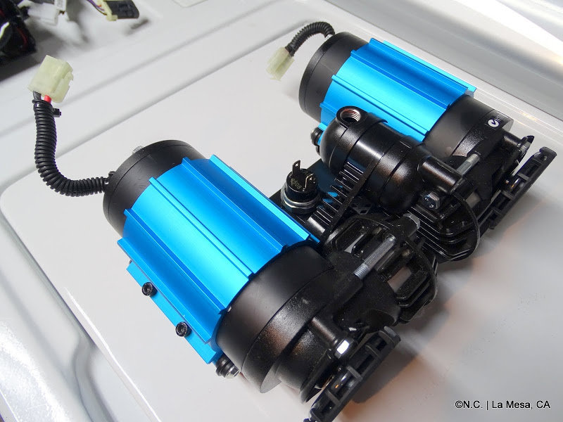

    I could be wrong but doesn't the ARB twin have a pressure switch built in?
    fatfurious2 likes this.
  18. Mar 7, 2016 at 9:48 AM
    #658
    Crom
    Crom Super-Deluxe Member
    Jun 22, 2009
    #18782
    9,642
    Nick
    San Diego, CA
    2009 4x4 DCSB Camp Supreme
    Millions
    yes it does. Works great.

    Custom 3 link, 40's etc..
    Oh really? So I don't need that pressure switch with relay?
  20. Mar 7, 2016 at 9:51 AM
    #660
    Crom
    Jun 22, 2009
    #18782
    9,642
    Nick
    San Diego, CA
    Millions
    Here is a picture of my ARB twin the the cover pulled. See that little round guy with two metal prongs in center of photo? That's the built in pressure switch.
    EDIT: Much better photo of switch
