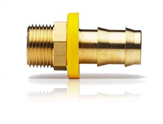

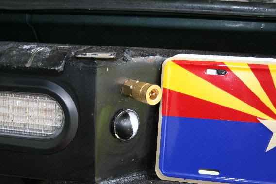

    How are you guys doing outlets like this? Can I just drill a hole in my bumper and use these two fittings ??

    Thats basically what I did :

    Did you use push to lok fittings or just regular barb? Did you use an air tank ?

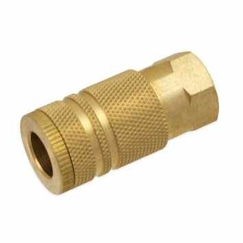

    You can, but before you purchase hardware I'd recommend using a "universal quick disconnect coupler." You will find automotive and industrial types, and normally you cannot plug one type into another hence the universal recommendation which will accept either type of fitting.
