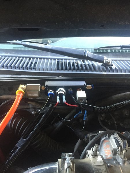

    Finished my oba today...EVERYONE of my push on fitting leaks horribly. They came with my tank. 4 are 10mm and two are 4mm
    What do I do?
    I do not wanna run new lines

    SF Bay Area (East)
    07 LT 4x4 DCSB 6spd Vagabond
    Drifter wedge camper, Dual battery, OBA, ARB locker, 4.56 gears
    Can't you just get new fittings? I have the Viair ones and they've held up well (knock on wood)
