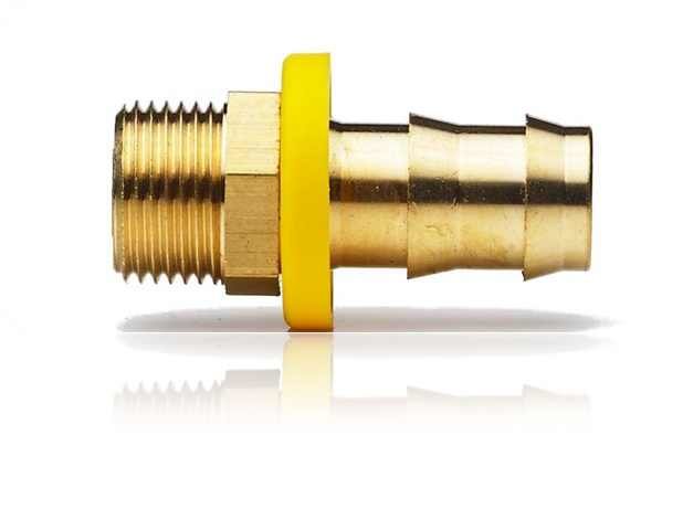

    There are no marks...they are from smittybilt. They leaked so bad the tank won't hold air for more than a minute or so. I think I am going to use 1/4" barb push to lok fittings from manifold to tank and use 1/8" barb for the air gauge.
    Seem ok??

    I plan on it. The tank is good but the fittings were clearly garbage. The hose seems okay
    You think the barbs will work good?

    The barbs will work fine. They are commonly used to repairing hoses. You just want them to be a tight fit getting the hose on the barbs and then use a small hose clamp as a "backup" of sorts. Most barb fittings have a max PSI but if i remember right most are 150 PSI or so

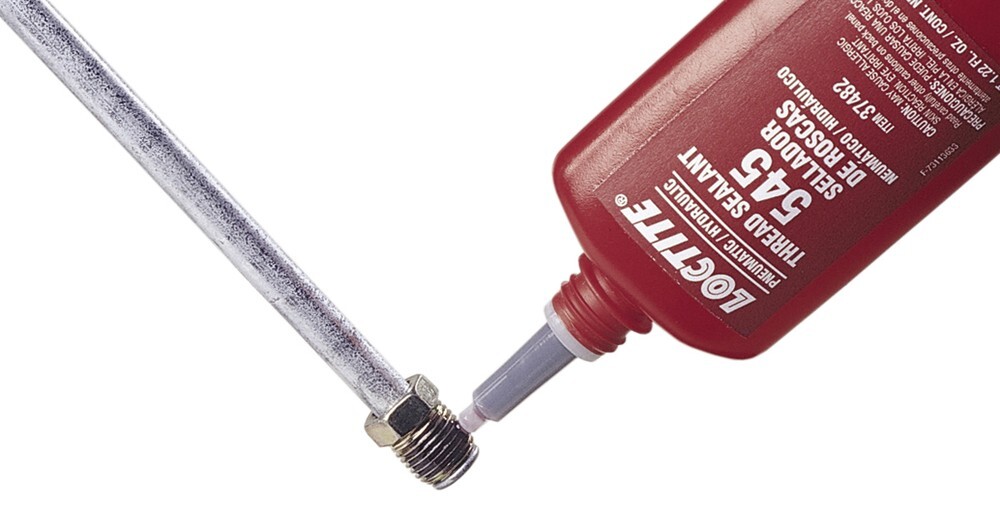

    Dear God no... 2 wraps should be fine, never would I think of 7-10... Your threaded connections should be NPT or BSP either way tapered and don't need torqued down.
    Ditch the tape and get some loctite 545 thread sealant.

    Can you get that at the hardware store? Yeah they are 1/4" npt except for the locker solenoid

    Maybe, I ordered mine on ebay. Yea the ARB solenoid is BSP, because Australia and England

    Yeah I used a 1/4" npt to 1/8" bsp...that doesn't leak at all...only the pressure switch and one barb. How muh of the sealant do you use?

    I use a small line down the threads, not slathered all around. It doesn't take much, it will cure under pressure (from tightening the fitting).
