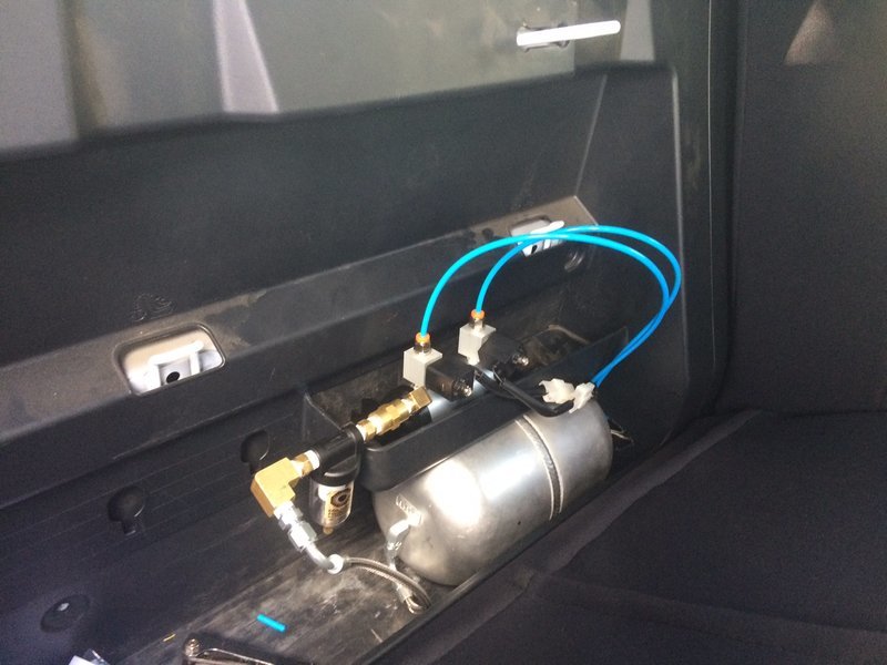

    I got it setup, tested, and no leaks! So happy with the way this turned out
    Now to run lines to the front and rear bumpers..... Need to start reading this thread over again

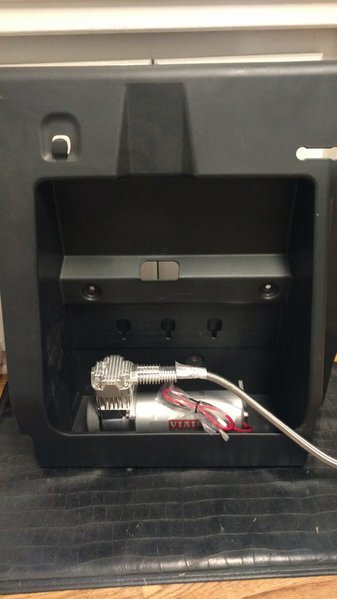

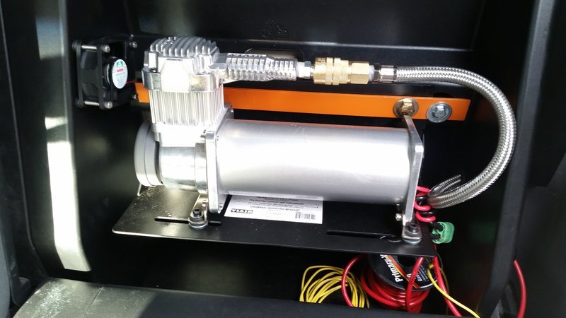

    where is the little compressor at? I see it peeking thru the bracket there but howd it fit behind the small reservoir tank? :confused:

    Yeup. I put my dual back there too. I don't think I posted pics in this thread....

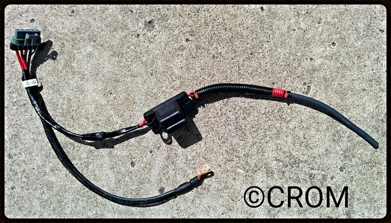

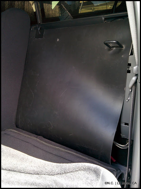

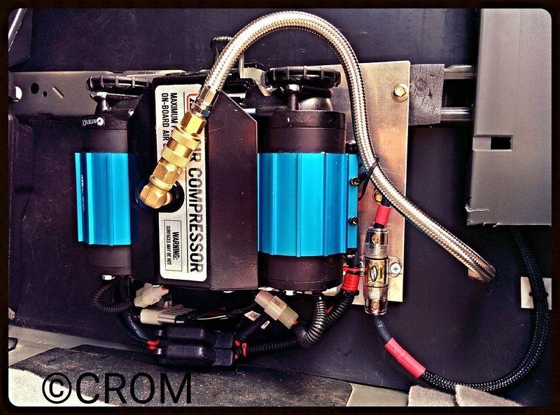

    The heart of my system. Twin ARB mounted to alum plate. Airline out the back wall, then 90*, tucks into frame rails, and terminated at hitch.
    MLV barrier over compressor.

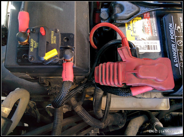

    Custom wire harness. 4 AWG welding wires power.

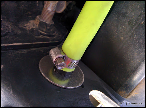

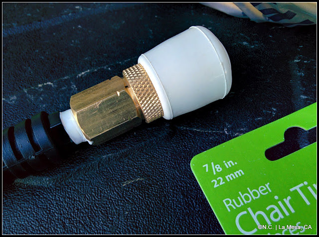

    Air line terminated in rear hitch.
    Rubber chair end protects air fitting.

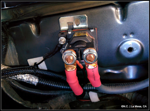

    Power
    Relay.

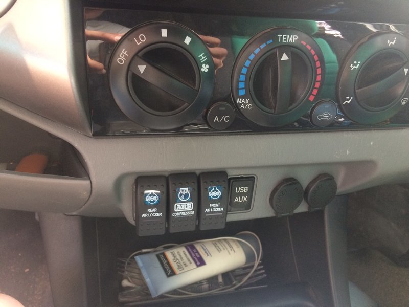

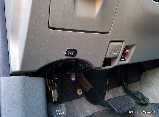

    I prefer this little black rectangular switch to the big ARB one. :)
    Fun project. Glad to be done with it.
    Lots of thanks to
    @MrGrimm , @AaronArf , @Nate87
    for sharing ideas, knowledge and experience.
    Nate87, AaronArf and fishfinder like this.

    That spot seemed like the best place. I used a dremel to cut a hockey-puck sized hole through the middle of each plastic bin, so I could run the SS hose through and still get a crescent wrench in there to tighten the fittings. It's much quieter than I was expecting, hopefully it's the same for you with the metal panel!
