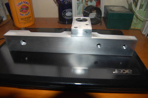

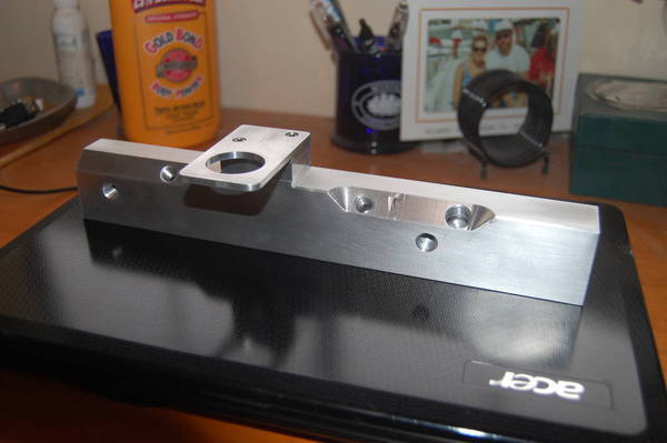

    This is the manifold for my on-board air. This manifold is 12" long and 1.75" high. The bracket on the top hold a regulator to set the pressure for the lockers at 80 PSI. There are ports on the front, top and back sides and the whole thing just fits into the cubby hole on the passenger side of the bed. The compressor is a Viair 400C and a 3 gallon tank is under the bed just in front of the rear bumper.

    Thats a nice piece of ART! Man, what was the price point to get one of them made? Or you said you did it yourself?

    I though about this project for a couple weeks. I planned like 3 different manifold schemes on paper and then once I had the regulator, solenoids (2), the fittings, pressure switch, etc. I set about fitting it into that bed-side cubby hole box. I had to abort the first plan as it just would not fit. This one has two separate sections with one part pre-regulator and the other post regulator. Due to space limitations I think I will have to run the pressure switch/relay under the truck mounted directly to the air tank if I can tuck it well out of harms way.
    I made this in my garage shop. Nice to have a full size mill.

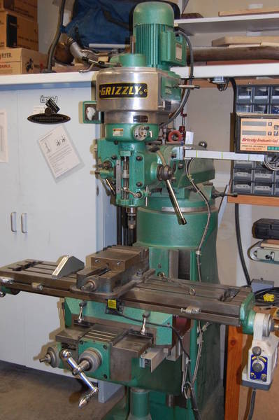

    Got a pic of you mill? just currious.

    My mill is a full size Grizzly brand mill (Chineese copy of Bridgeport), and I use it a lot for a hobbyist. We have a couple Bridgeport mills at work and they are a little bit better in some ways but cost 3 to 4 times as much new. I tried to buy a used Bridgeport, but all I saw were in rough shape and they still wanted big dollars. I bought a benchtop mill first, but found its limitations right away and was able to trade up without loosing a dime! Having a mill is just the beginning, you need all kinds of tooling and cutters before you can make anything. Same with a lathe.[​IMG]
