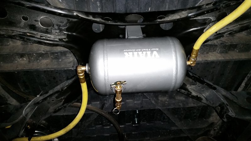

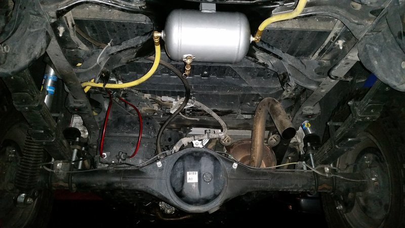

    Workin' on Workin' on it
    Thank you.
    It was a real PITA to fit it up in there.
    I'll be mounting a tank under the bed soon.
    Crom likes this.

    Not sure if you've already chosen a pass-through spot from inside the cab to outside, but there's a little rubber grommet right under the rear seats in the middle that I ran my air lines through. I don't have a photo, but if you get under the truck you'll see it right above the driveshaft, and it just pops out. It's a straight shot into the plastic compartments if you drill a hole in the bottom.

    I used the hole in the back of the cab (same as @Crom). It's a really tight space if you retain the plastic bin like I did. I also decided to use a bulkhead coupling so I had to drill the hole a bit.
    Crom and fishfinder[QUOTED] like this.

    Those of you who run a tank, is it setup between your compressor and the manifold, or is it an open setup with a "T" connector? I have mine plumbed so that my compressor charges the tank, and everything is charged directly from the tank so that my compressor only really needs to run when I'm airing up/running tools, and the lockers can actuate dozens of times without kicking the compressor back on.
    I'm noticing a lot of moisture collecting in my filter, which I assume is from condensation in the tank. Do any of you see the same thing?

    I just finished getting the tank mounted up. It was outrageously difficult. I asked the wife for help, but I had to quickly send her back inside because she started asking too many questions. I can't believe that I actually got it mounted in that spot...very tight clearance for the bolts.
    fishfinder, Crom and Glueman like this.
