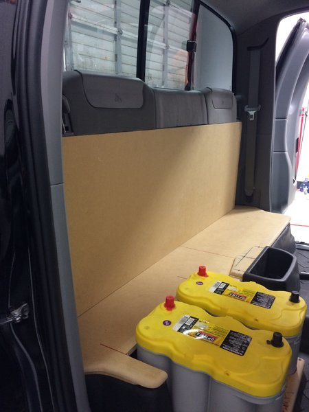

    Got this to install at some point. Just have to figure out:
    1.) Where I can/should mount it
    2.) What size wire to run from the battery to the compressor and if I can just snip the gator clamps off and splice the wires together
    It's a VIAIR 440
