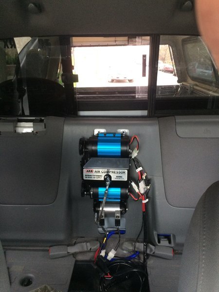

    I'm still working on the wiring, so I'm not sure how loud it'll be yet, but here's what I'm doing:

    That location would also be easy to box around if it is super loud

    Yea but boxing around it (depending on material) might not be good for air circulation

    I don't find the dual ARB compressor to be excessively loud. I have mine behind a passenger seat in my DC.
    I will say though, that you have chosen a very unusual place to mount it being inside the cab of an AC truck. Didn't want to stick it in the bed or under the bed somewhere? The ARB unit is relatively well sealed against the elements...

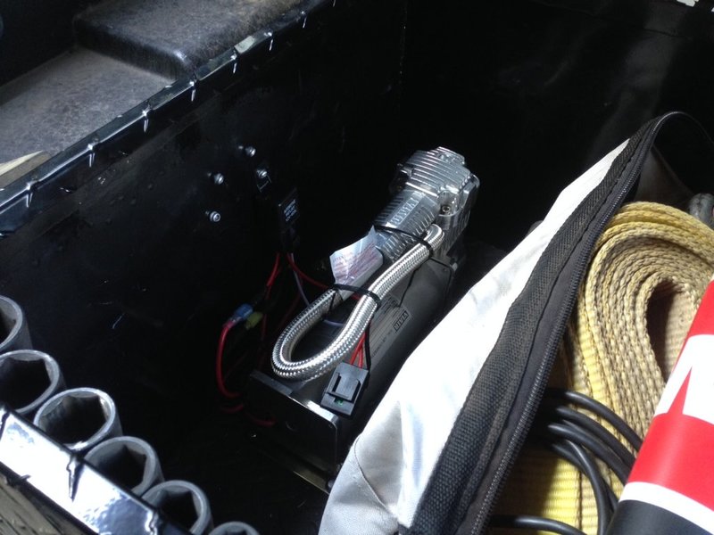

    Yea interesting area for sure. I'd look into putting some type of protective barrier around it. I did something with my 2nd air compressor in my tool box. Breathable but secure barrier:

    Agreed 100%, I would definitely put vents to get air flow.
    I am putting mine in the AC rear seat storage area, boxed in for protection from hitting gear but vented right off the side of the storage area towards the door to ensure gear can't block the air flow.
    Do you drop the seat when airing up tires? Overheat issues?
    Mine will be drive side, opposite of the dual batteries

    You're not the first person to question that mounting location, but I liked it being in the cab specifically because it would be protected from the elements. It may eventually move it to the bed once I figure out permanent storage back there...but for now the holes are drilled and it's staying right were it's at.
    I really like what you've got in progress and am thinking of removing my seats permanently as well. I will be watching your build thread. :spy:

    No need to drop the seat. When airing up tires, the compressor runs for 5 minutes or less.
    And air flow does happen in my case because I pulled out the plastic bin and that created some space at the bottom where fresh air can enter. I also did some controlled tests with an IR gun to be sure. :)
