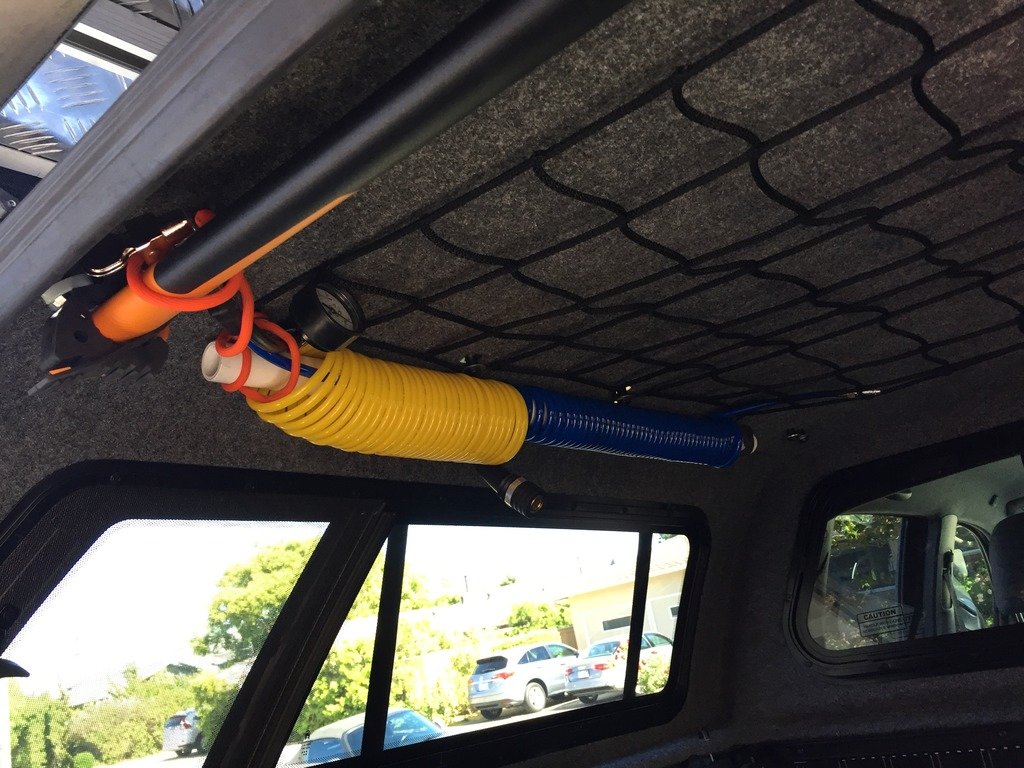

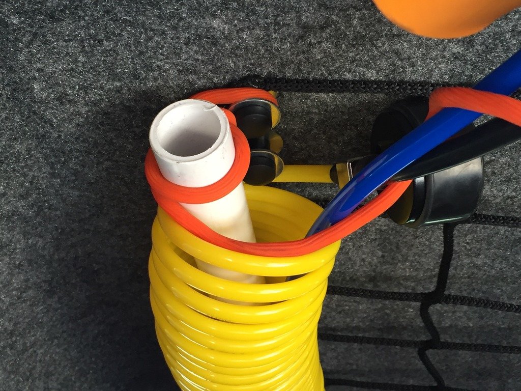

    Hose storage idea. Pvc tubing and...I forget the name of those rubber coated wire wraps.

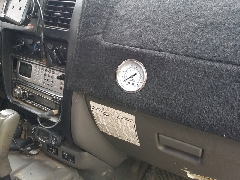

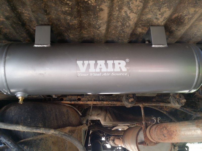

    Got the onboard air finished, Works great.

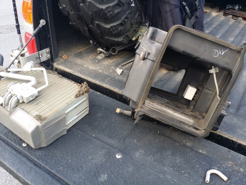

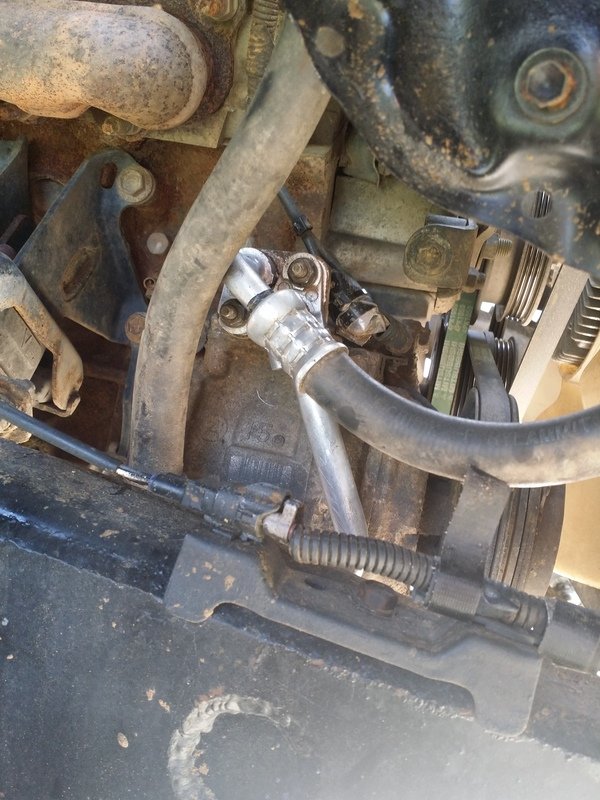

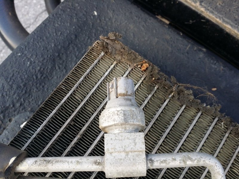

    Started on converting the stock denso a/c compressor over to onboard air.
    Pulled the a/c condensor, drier, and lines out.

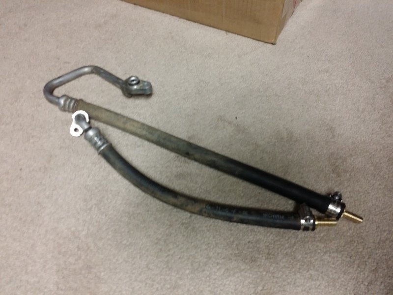

    Salvaged the factory lines to help handle the heat coming from the compressor. Low pressure line took a 5/8 to 3/8 barb adapter. High pressure took a 1/2 to 3/8 barb adapter.

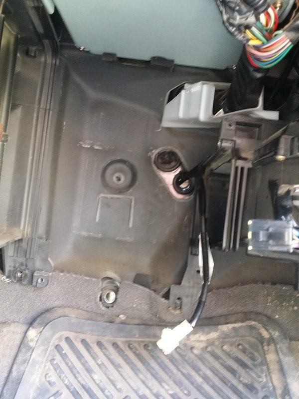

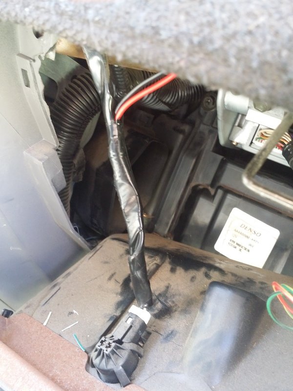

    Also pulled the passenger side glove box to get to the a/c evaporator to remove it and gain access to the high/low pressure switch.

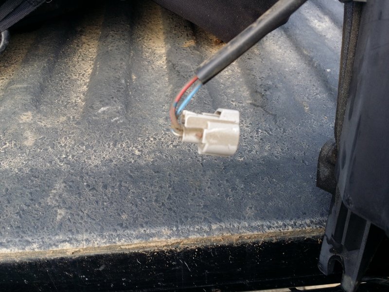

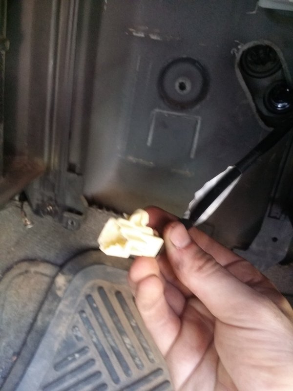

    Toyota uses a single switch to measure both the low pressure cut off as well as the high pressure cut off (per fsm)
    Going to cut the connector off and use the two wires to wire in the cut off pressure switch for the air line pressure. 90psi on - 120psi off. This should allow full use of the factory a/c button to turn on the compressor.

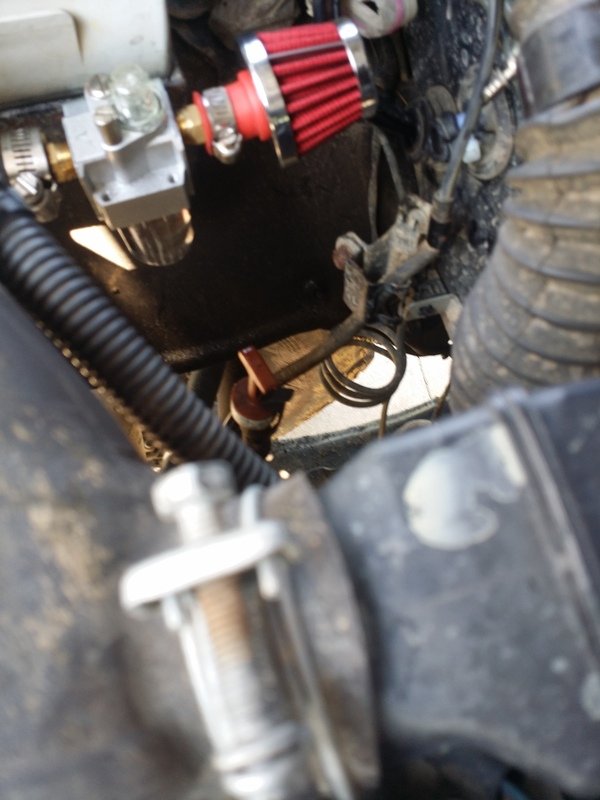

    The rest of the parts I pieced together. (Oil mister, seperator, pressure release valve, check valve, etc.)
    Cleaned up the factory lines from the compressor. These are good to keep in order to help with the heat coming from the compressor.
    From there the intake side has a small air filter and then a drip oiler/mister to keep the pump lubricated.
    Output side has roughly 4ft of hose before it enters the oil seperator /regulator.

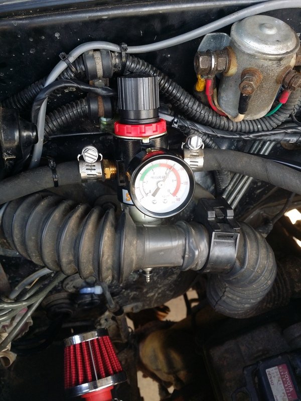

    From there it goes to the manifold. In order (pressure switch (90 on 120 off) high pressure line with check valve, plug, pressure line for the in dash air guage, quick coupler, then finally high pressure output to the tank.)

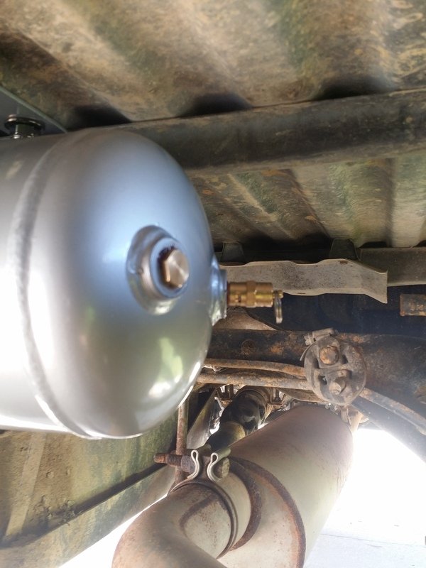

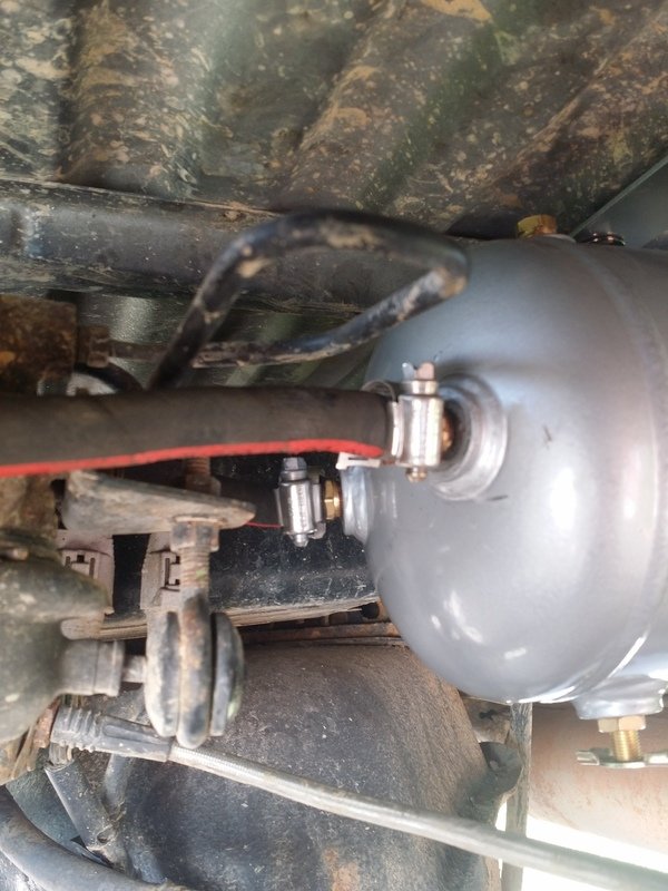

    Tank fittings, driver side.
    Tank fittings, passenger side.
    2.5 gallon tank mounted on the "low" rib sections of the bed. Added 1/2" spacers on the driver side for drainage.

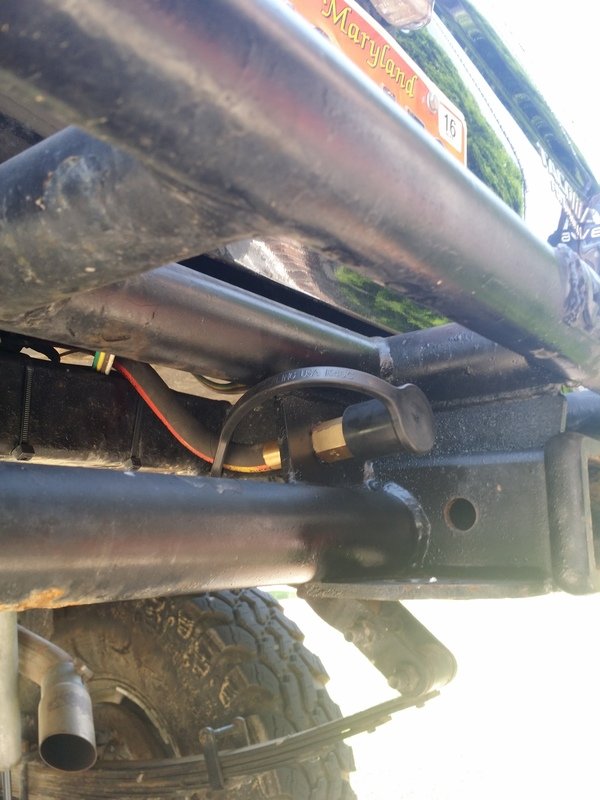

    Finally the hose terminates at the rear bumper with another quick coupler.

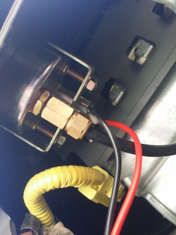

    Area behind the dash and glove box where the a/c evaporator was mounted. Also where one of the grommets where used to run the pressure switch wires off the factory a/c pressure switch harness. And to run the line for the pressure guage.
    Gauge mounted, back light wired, and hose attached.
    Power was tapped from the factory glove box light.
    This is the factory end that connects to the original wire harness to run the a/c pressure switch which is now attached at the viair pressure switch on the manifold.
    A/c evaporator box mounted back of minus the actual evap core. Factory pressure switch connector re-attached.
    Final product, gauge mounted.
    For oiling, these denso units are recommended to run PAG 46 oil.
    Reference from this page. http://www.aa1car.com/library/pagoil.htm
    Tacoma 95-04 V6 at least use the Denso 10P.

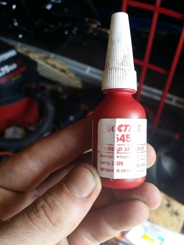

    Loctite 545 for all fittings, expensive but great stuff.
    Since this was wired into the factory harness, enabling the factory a/c automatically kicks up the idle.
