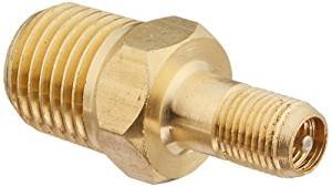

    This setup will also keep your compressor from running as much, when your tank is already full, when you run your locker.

    So I take it both ideas work - Its just whether I am okay with the restriction at the 1/8" fitting.

    Yea, teeing off the 1/4NPT port where the pressure switch is better.

    I think lastly you will want a, Safety pop valve, and tank valve somewhere in the equation

    Yes, the safety pop valve will go directly on one of the tank ports.
    Tank valve?
    Please elaborate

    drain valve, sorry

    relief valve.

    that's what I mean by safety pop valve

    yes, for condensation
