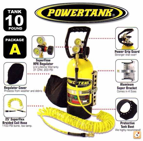

    3 link solid axle 2011 Tacoma 4x4
    This is what I'm getting for my rig.

    Nice!

    I find myself going back and forth on this topic between An Air compressor w/ a tank & a CO2 Tank.
    I find myself leaning toward the CO2 Tank. I plan on using it to fill tires, run some tools, and run a front locker when I regear. It seems to be a much simpler option.

    My experience comes from paintball, and from what I see with CO2:
    -when you're out, you're out. I wouldn't want that for lockers, and I'm not sure there's any setups using CO2 because of that.
    - It wants to be liquid in cold temperatures and not expand, so you get less fills.
    - It chills as it's escaping from the tank, so the tank gets cold, anything it's blowing into gets cold... Not only do you get condensation, but that's going to ruin anything rubbler, like o-rings or other rubber fittings.
    -Anything above a 9oz tank needs to be hydrotested
    -You can't fill it yourself
    On the plus side, it's fast. Really fast.
    The reason it works for tires (at least from what I can assume) is that it's filling faster than it can freeze, and tires can take the cold temperature.
    I'm not sure why they don't have high pressure air tanks for offroad use. You still can't fill them unless you have a compressor that can do several 1000 psi, but it's incredibly better than CO2. No temp problems, consistent, easier to find a fill...

    Either way, you are going to have to run the line, solenoid, and electronics. As stated above, When you are out, you are out. Even oif you spring a leak in a tank. You can disconnect the compressor and direct connect it to other things and it will still work.

    I hear both of you. I guess my theory is how often does one use a front locker. How much air is required to activate it. I would bet a small co2 tank could run just front locker for a weeks worth of wheeling. If I ever did run out I could swap a different tank or still hook up a portable air compressor to get me through that particular trail. I guess I just don't wheel enough, but 1 20 lbs tank seems to last people for months. I have a electronic E-locker in the rear so OBA is not an issue there. Maybe I'll go nitrogen.
    My only concern with compressors is they seem weak. What kind of CFMs can you all get from your systems.

    CO2 can also cause valves to freeze open and such...You CAN fill your tank at home, I used to fill my 20oz CO2 canisters for paintball...
    Nitrogen or scuba tanks is also another option.
