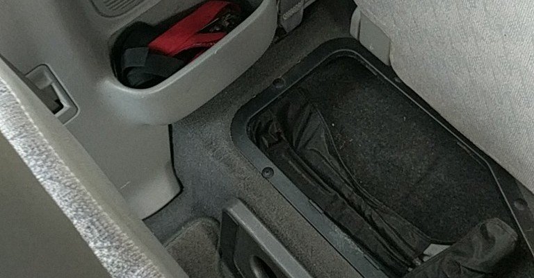

    Has anyone seen a first gen, or have a first gen, that used the passenger rear compartment for the compressor?!
    I would like to put my dual arb compressor here but mounting it securely in there is a bit daunting right now. Anyone have any thoughts?

    @rngr put a single ARB in there

    Purely a guess, but I don't think it will fit. The single fits, but with very little room for error. The way you see mine mounted is the only orientation that would allow me to close the lid.

    That's awesome, nice work! Yes it will fit in more than one orientation. The dual is very flat but its a large footprint so making a mount is going to be tricky, but your work has inspired me and sometimes that's all I need! I'll see what I can come up with and post it up.
