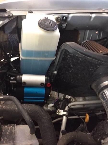

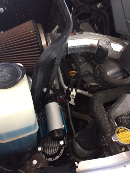

    Went with a single ARB (CK12?) with the Slee mount, which was really clean. The wiring from ARB was perfect. Just use it to air up, put a chuck behind front bumper and use a hose that reaches the rear tires no problem, really easy. First pic is just to show truck, in it's favorite place, Baja!truck 1.jpg air 1.jpg air 2.jpg
    These pics are before I hooked up the line and pressure switch. Might run a line to the back if I get motivated.

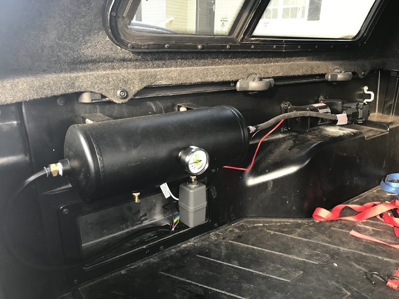

    Has anyone ever mounted a pressure switch on the bottom of the tank?
    I didn't realize at the time when I mounted mine that the instructions says not to do so. What are the concerns other than ruining a pressure switch?
    I don't feel like remounting my tank in a different location right now because it's cold out.

    Thats the worst place to put it, IMO. Water and debris can accumulate and interfere with its function. If it fails to shut of the compressor, either the tank or an air line with fail suddenly.
    jamiec likes this.

    What if I put the switch on an air line and mounted up above the tank, would that be ok?
    Here's my setup right now
    Diesel475 likes this.

    @jamiec, what you can do is run a line from the fitting that is on the side of the tank (facing the side of the bed) to a distribution block (manifold) and mount your pressure switch to the block. I'd say run it towards the compressor and mount the block to the side of the bed behind the leader hose. That will get it off the bottom of the tank and also into a spot that is less likely to be damaged by stuff in the bed.
    jamiec likes this.

    Thanks for the info! I'm extremely new to onboard air so I am learning as I go. I'll check lowes out tomorrow and see if I can find what you're talking about. I've never seen an air distribution block so I'll have to look into it. If you could share a link to one I'd greatly appreciate it.
    I like your idea a lot, its better than my idea. I was going to remove the tank from the bedside, switch the tank 180° and mount it to the bed floor. That way the pressure switch will be on its side and it would be inside the cubby that my air lines are running through.

    Ebay, Amazon are good places to look. Look down in the "products discussed in this thread". "Aluminum rectangular manifold" for reference. You can get one with however many ports you want, just make sure it is the right size for whatever airline you want to use.
    If all you plan to use it for is the switch, you can skip the block and get 1/4" push to connect fittings. Use a 90* fitting on the tank (if your is the same as mine, you will need 1/4" NPT) then get a female NPT push to connect fitting to mount on the pressure switch. Run 1/4" airline from the 90* to the pressure switch. I'd still say mount it behind the leader hose.
    jamiec likes this.

    Ah, even better! The port facing the bedside has my check valve right now. So I'll just move it to where the pressure switch is now and get the 90° to put back there and run it as you just mentioned.
