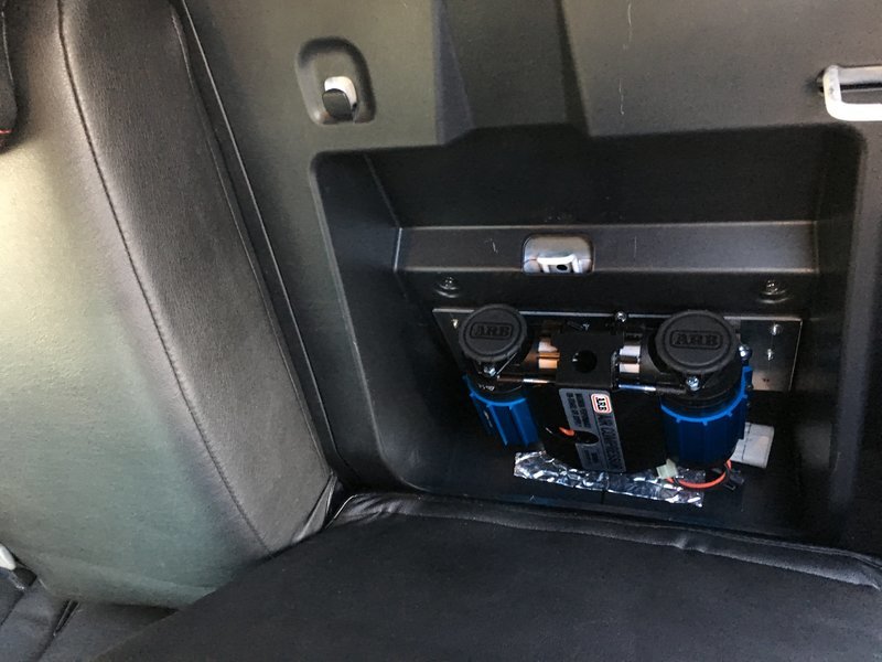

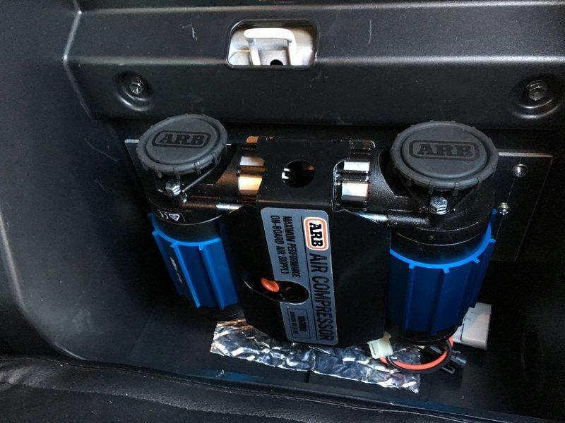

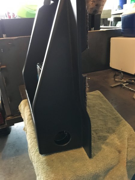

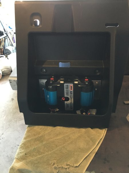

    For anyone that is interested, I was able to fit the ARB Dual Compressor into the first gen's passenger cubby. I'll post up some more pics once I finish the wiring and plumbing.

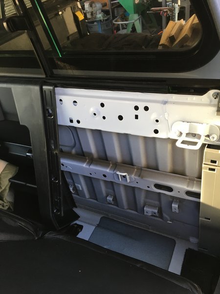

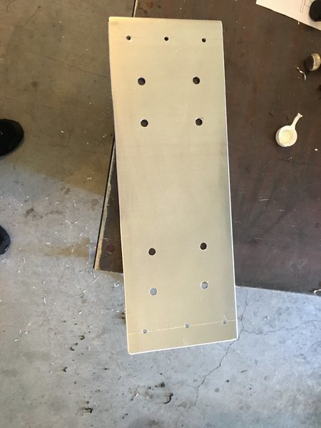

    Got around to mounting mine yesterday but need to finish wiring (easy part). I placed it behind the rear seat in a DCSB. Mounted on a piece of aluminium. Pretty clean install and everything went smooth thanks to this thread. ;)

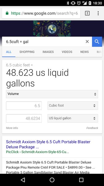

    One slider, 6.5ftÂł I find that hard to believe.
  20. Apr 23, 2017 at 1:20 AM
    #1220
    Ritchie
    Ritchie Well-Known Member
    Dec 24, 2012
    #93649
    1,930
    San Diego (North County)
    RC Step side Pre-runner
    2.7 w/auto, 4WU 3 link, F & R Diamonds, ARB's F/R w/ Yukon 5.29's, Inchworm 4.7 Lefty, Deavers, ARB OBA, Schrockworks up front.
    Sandman,
    You are correct... I meant gallon, my typo.
    The complete DS slider is air tight and each tube does hold air. Had to make them myself due to nothing available for the RC at the time.
    Good catch... going to edit that one.
    Thanks.
