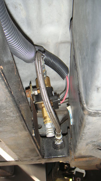

    Ah... this is where the 2012 Peterbilt fan clutch comes in...
    In the pic, to the RT of the ARB manifold, you can see an AN fitting to braided line. That line goes to the fan clutch switch which turns off/ on the feed to the slider.
    If I damage it, and I have, I shut off the slider feed and retain use of the lockers.
    Make necessary repairs to slider in the shop and off we go.

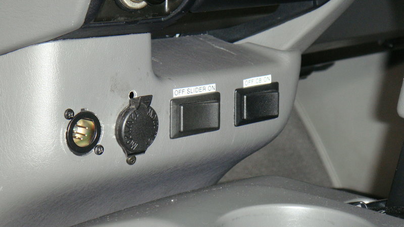

    Here is a photo of the switches.
    I'll get a good shot of the hard part switch this afternoon.

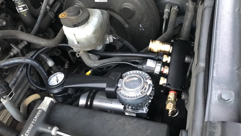

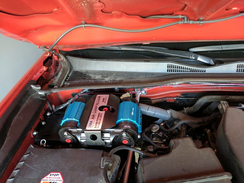

    To add on, Slee makes a really nice mount that I recently purchased for my own. It's a twin but the instructions mentioned that it works with a single as well.
    http://www.sleeoffroad.com/products/products_air.htm
    Here is a photo of mine pre-wired:

    Nice install.

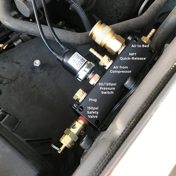

    I had issues with the supplied ARB line from the compressor to the manifold, it was too small in diameter. Condensation causing rust plugged it up which made the compressor work too long to fill my slider.
    I had one custom made which cured the issue.
    Where are you planning to install the manifold?

    No manifold for my install. The compressor will be for filling tires only at this time. Super overkill for the job but I got a really good deal that I couldn't say no to. The mounting bracket does allow you to mount a manifold as well. It would mount to the left of the compressor.

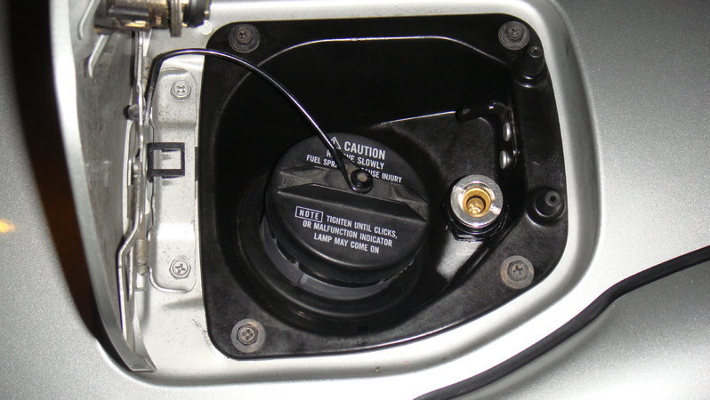

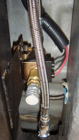

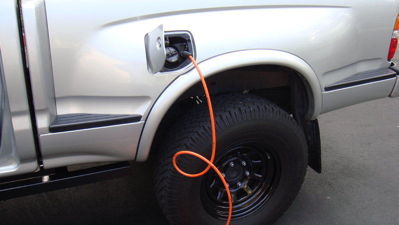

    I installed my air chuck inside the fuel door, it's out of the weather and I don't need to lift the hood.
    Also, here are a couple pics of the Peterbilt fan clutch solenoid.
