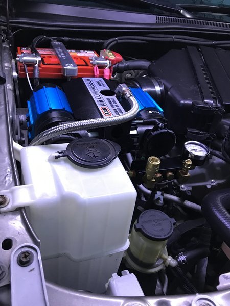

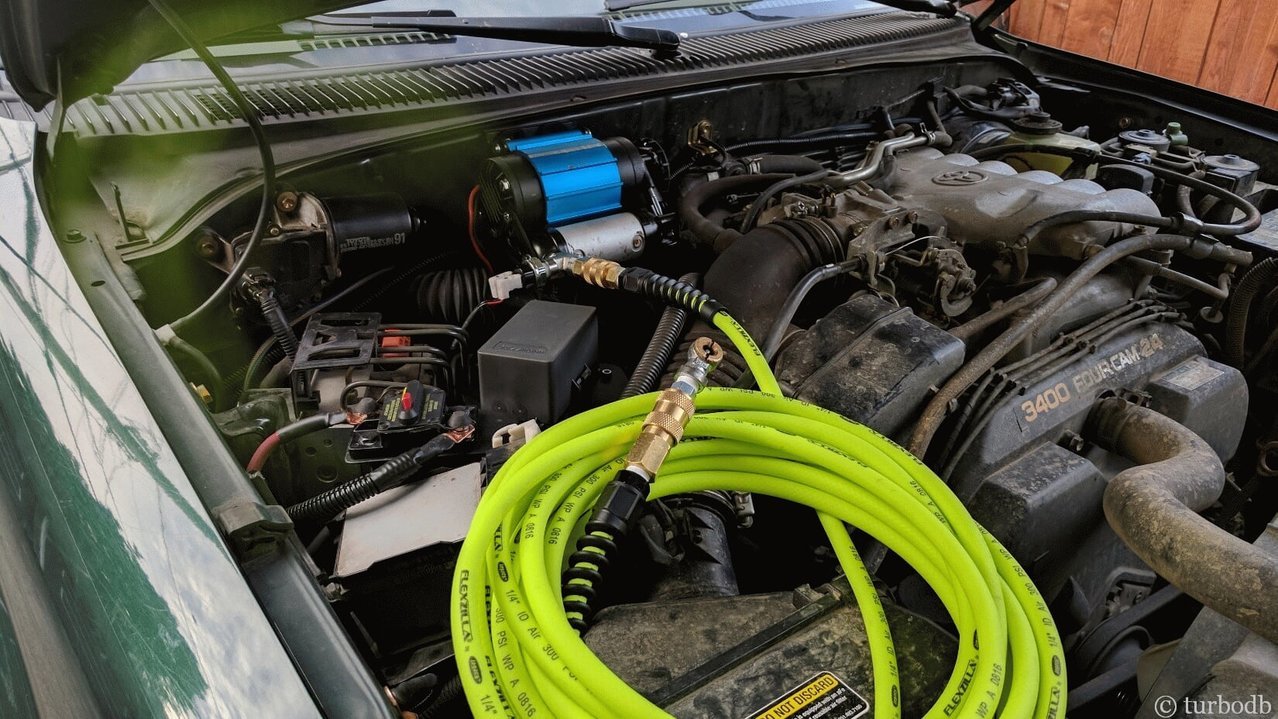

    Got my compressor installed about a month ago, but finally got it written up and posted to my build thread. Came out great but is definitely custom. Not very much room in the engine compartment of a 2000 V6 with ABS, cruise control, and AC!

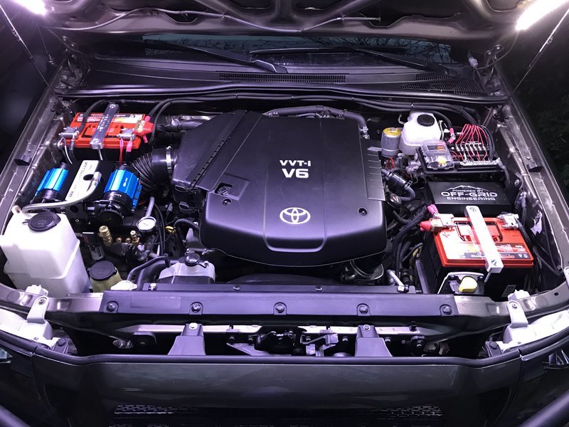

    ended up doing a custom intake with my snorkel which also allowed me to fab up a special little bracket that puts the twin right inline with my Off-Grid Engineering aux battery. very pleased with the end result!

    Super clean engine bay!
    and I mean that in all aspects

    thanks! that pic was at Overland Expo west where she was on display for the weekend at Off-Grid Engineering's booth

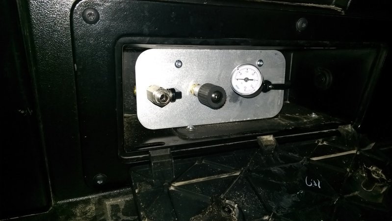

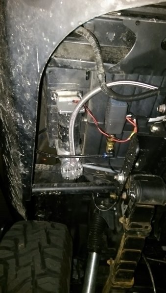

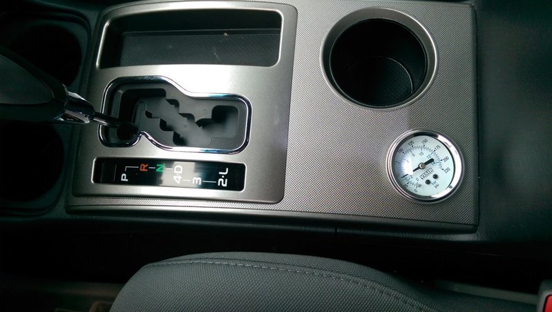

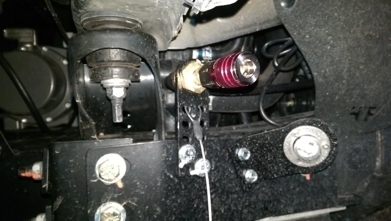

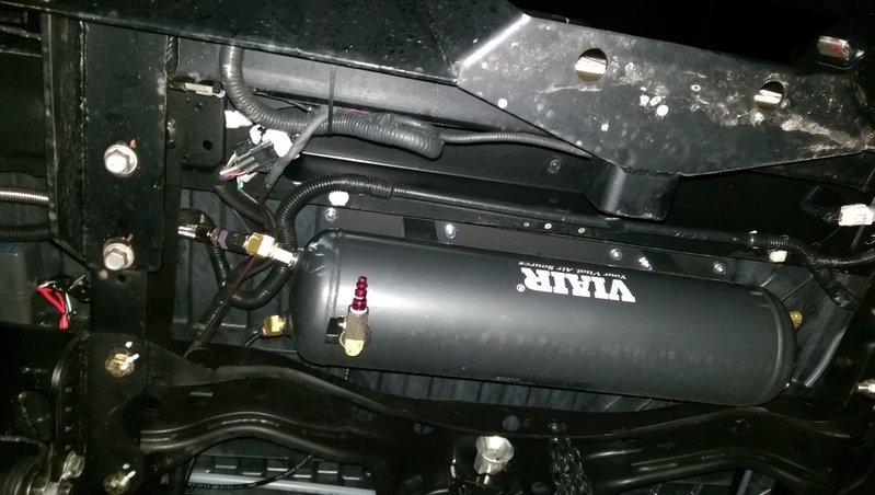

    Viar 2.5 gallon tank and compressor with air to air system at each wheel. Tank in spare tire compartment, compressor in bed compartment and switch in console switch panel in cab.
    @each wheel well

    Do you?
    I used 3 of them in my most recent. 2 on the control unit and one on the tank. Pics 5 posts above yours. They are very common in oba set ups.
