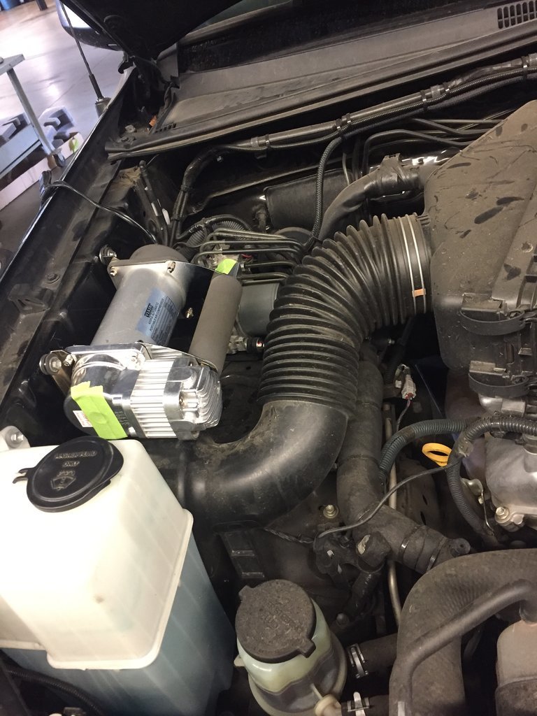

    Already have my 300p mounted behind the air intake filter :) . Was pretty damn easy to do on the 3rd gen. Kep it on the plate, but drill spme holes in it to fit! The rubber screws are actually good. We used one of those metal strap things on the handle so it only had a little give for vibration.

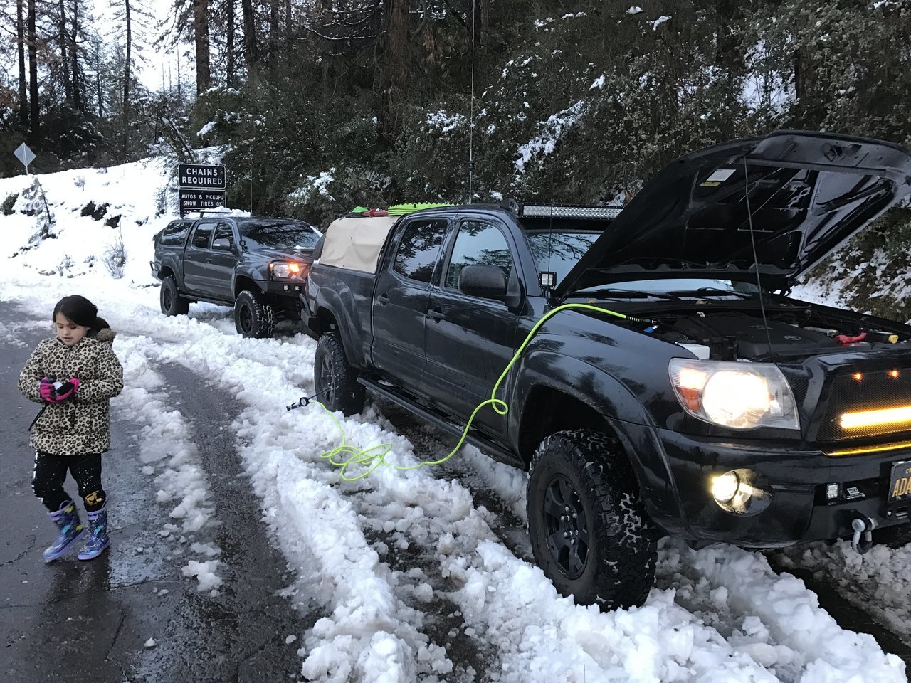

    Love my viair 400P-A, mounted it in the engine bay. No issues in the past two years and before I hard mounted it, I was airing up 2-3 rigs every time we would air up. Now it's just me and the occasional other person. Obligatory pics....
    @Alfred in the back.

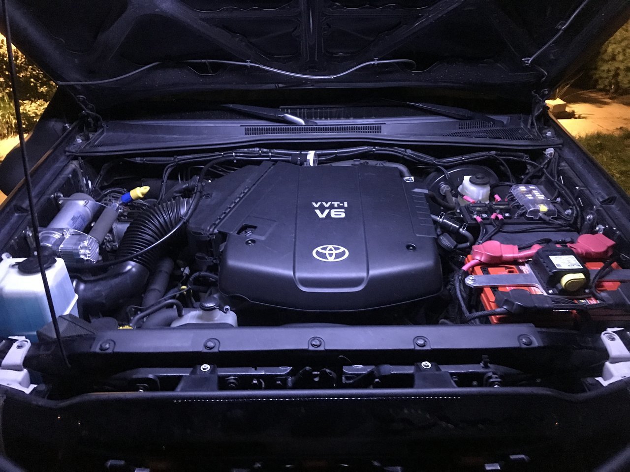

    I just cut off the battery clamps that came with it. Added ring terminals and attached to the blue sea fuse block positive/negative bus terminals. It has a switch on the back side of it so I just turn it on when I attach the air hose. Just left the 40 amp inline fuse that came with it. Wiring it was the easy part.

    Just a heads up. Most blue sea fuse blocks have a max amp rating of 30 amps per circuit. You may want to research yours and reconsider hooking up to it. I've got a dual arb and went straight to the battery using the inline fuses. My first thought was to use my blue sea but then went and googled the specs for the model number fuse block I have.
    I have a buddy who lost his truck on the trails due to an engine fire started by wiring problems...so it does happen.

    I know, I didn't use one of the circuits. I left the inline 40a fuse that came with the compressor, and just connected it to the buses for positive and negative that come from the battery to the fuse block. They're like 4 gauge wires I think, I can't remember. Good looking out though. :cheers:
