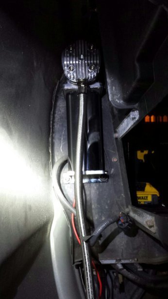

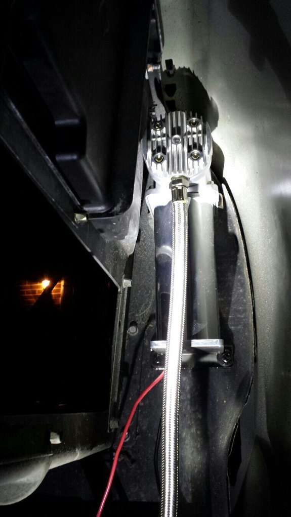

    Skygear -- what model compressor is that pictured on the metal bulkhead behind the light? Crawled around under my truck today debating my options. Curious as to what model that is, so I can see if the Air zenith I'm planning on using measures out similarly. EDIT: The damn AZ OB2 Compressor weighs in at 19lbs...wonder if it can even handle that weight bouncing around on it??
    Where'd you get that 5 gallon tank? Looks like it fits tight up there with very little hanging out.
    I really want to go aluminum but a pancake tank is sounding like the better option. I could easily mount to the factory spare x-member and have more air capacity. Plenty of misc sized ports so I won't need a manifold block pending the compressor stainless steel leader hose reaches the tank.
    Worried about having low hanging fruit though...supposedly its 8" tall, not sure if that's including the mounting legs.
  14. Dec 15, 2013 at 3:19 PM
    #134
    skygear
    skygear                    
    Nov 6, 2011
    #66558
    8,414
    The tank i picked up is the Accu Air 5 Gal Aluminum tank. I went with them for 1 reason. The tank did not have the mounting brackets welded onto it. instead there were 2 bolt holes. Their tanks have numerous holes on them too. I would have to look again, but iirc, theres 2 on either side (4 total), 3 on the front, 1 on the bottom. Might be more there I cannot remember. After mounting it there. I really was considering going up to a 7 gal or 9 gal. Looked like I could squeeze one in there.
    I know you want that pancake tank, Cant sway you, thats fine. things work for different people. Realistically, the mounting spot I chose is optimal for a tank. Couple hose clamps and your golden.
    Compressor is the 400 series viaiar. All of them are the same form factor. Some longer than others.
    As far as weight goes, those bulkheads are part of the bed. Part of where the tailgate connects to the bed. So it has to be durable. As long as you bolt it down securely and it is not actually ''bouncing off of it", you should be fine. Strip that monster down, take any base plate off and se if you can shove it up there on the passenger side. remove your inverter plug to assist in the hand off if you have a second person. @~20#, I would recommend a second person. .
    There was clearance on both sides of the compressors and I had plenty of room to either go farther up on that bulkhead, or lower it some.
    Your choice in tanks is worrying me. If you have no armor there, boy, you will shear some connections off, even if they are 90Âş fittings, shearing could be a real and present danger.
    Might be able to mount a smaller capacity tank in the same area on the opposite side. (fender area, bulkhead) - I mean, people have mounted spare battery's there. Why not an air tank.

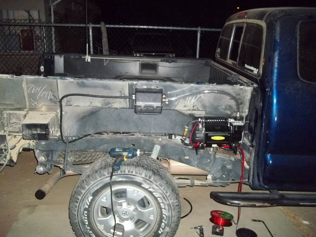

    As far as the space goes for the compressor. Look at this space here.
    3u6ymydu_b384d19ba6a14534d030a9c7e531f8660543e2f0.jpg6uvugage_2572f4ca2436563a9c5c8d10bd2f6567460d36c4.jpg
    If you take the measurements, and use a piece of paper to adjust for scale, you would be able to measure and see if the compressor you want or have will fit in there. the height and length are null points in that location. the width would be a factor to measure but not an issue from what I remember measuring back there. Just glancing at it. You would still have enough clearance.
