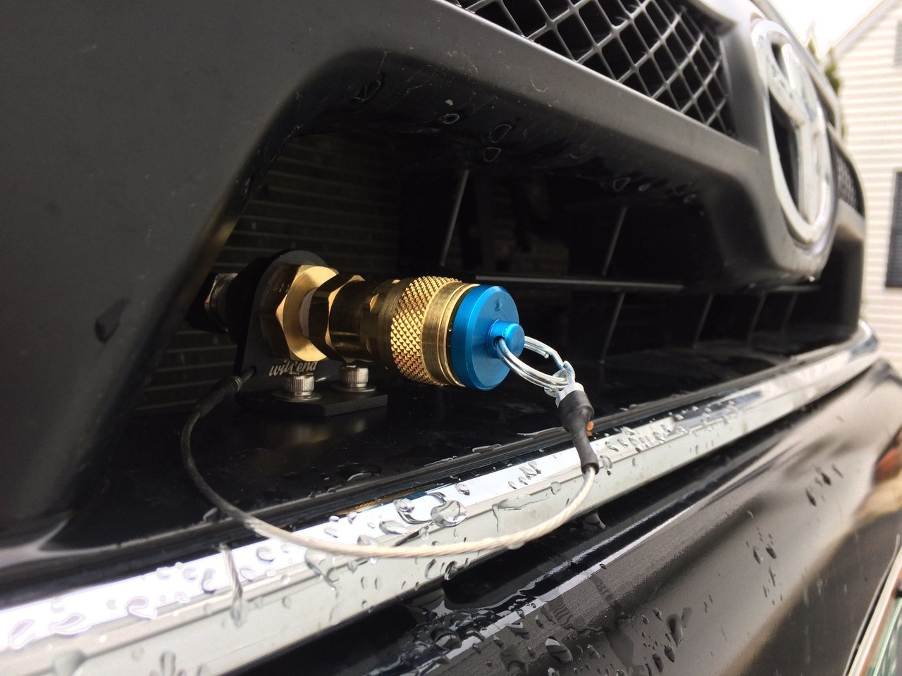

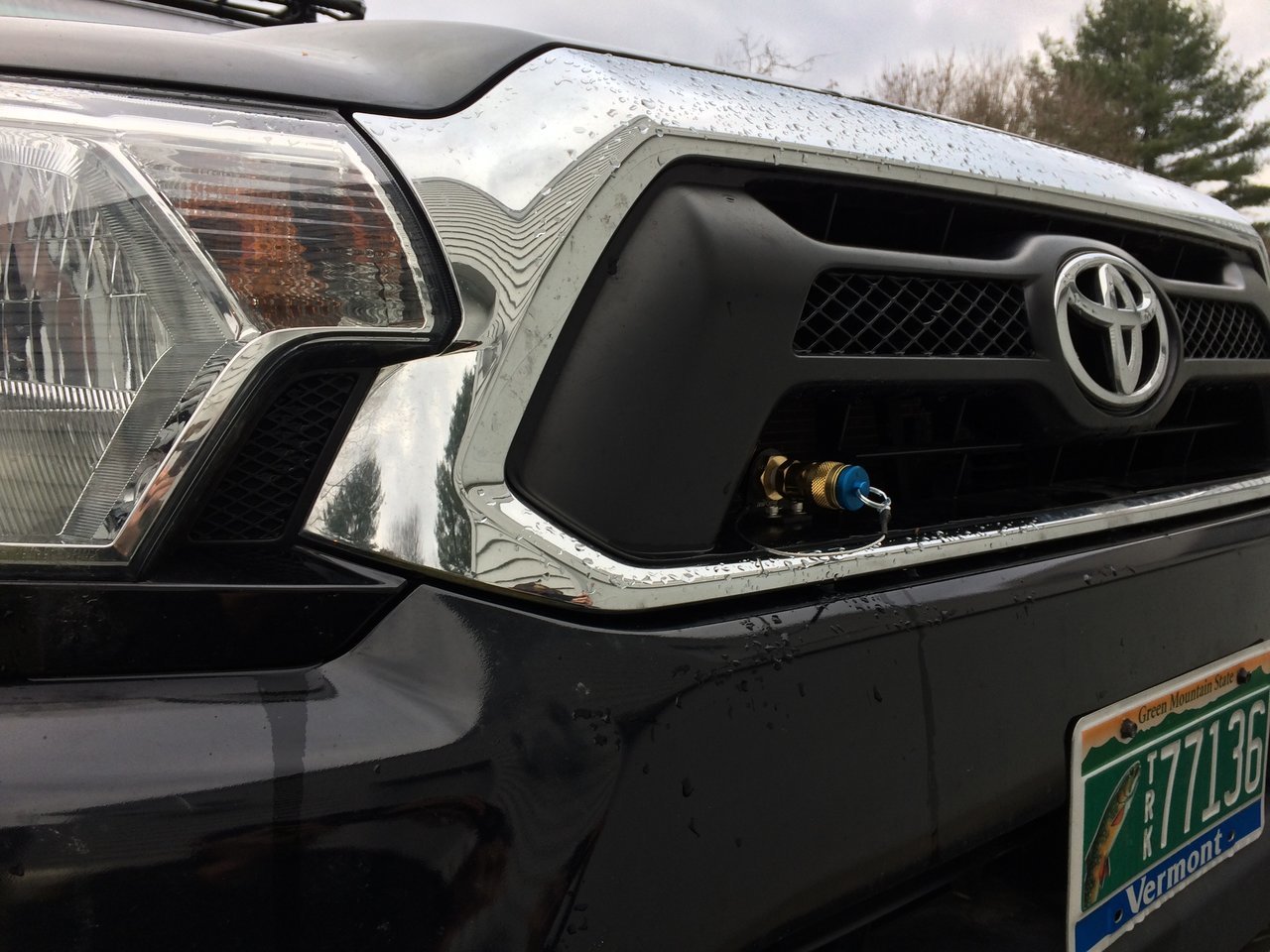

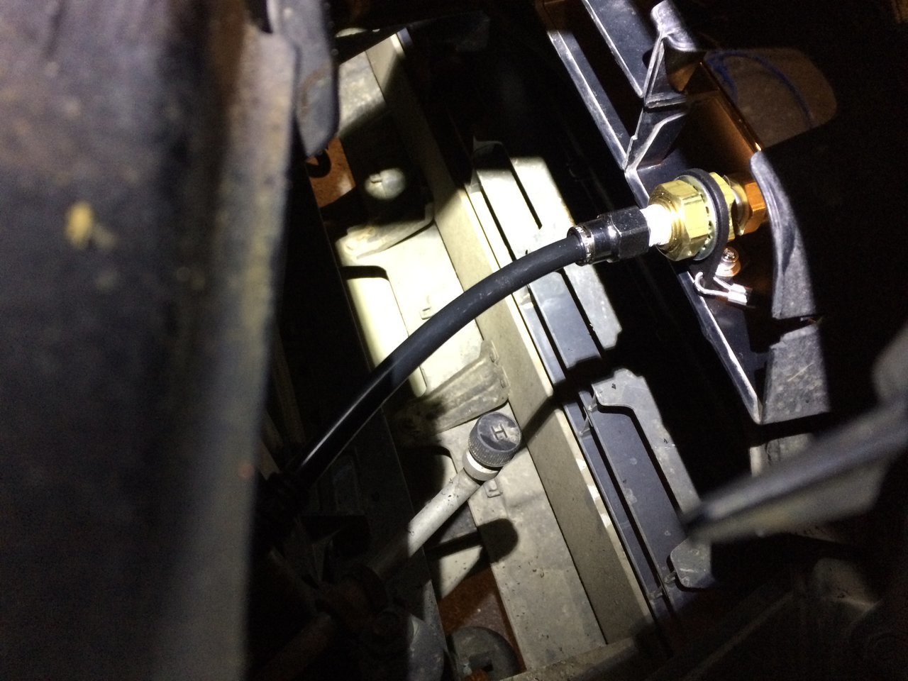

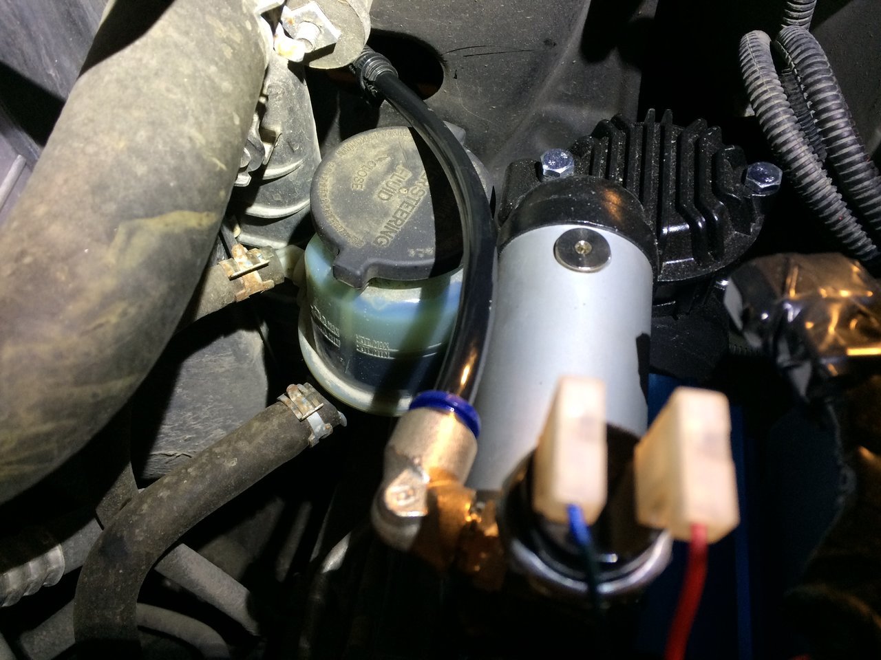

    Figured I'd post a few pictures of my onboard air setup. ARB single compressor, slee bracket, with some misc fittings and a bracket from Wit's End.

    Awesome I got a single as well are you running air lockers?

    Nope, well not yet. Right now it's just for airing up the tires. Well that and inflatables for the beach!

    Ya that's my primary use for now as well airing back up did you use the wire harness that came from ARB , if so what did you do with the connections for the lockers?

    What kind of connector/cover is that coming out the bumper?

    I taped them to the main bundle of wires so they just look like a bump. That way if/when I add lockers they're accessible and clean.
    jc11taco89[QUOTED] likes this.

    The bracket and the cover are made by Wit's End: http://absolute-wits-end.com/ the fittings/connector are Parker. I also put an aluminum plate on a the bottom, so there isn't just a bracket bolted to plastic.
