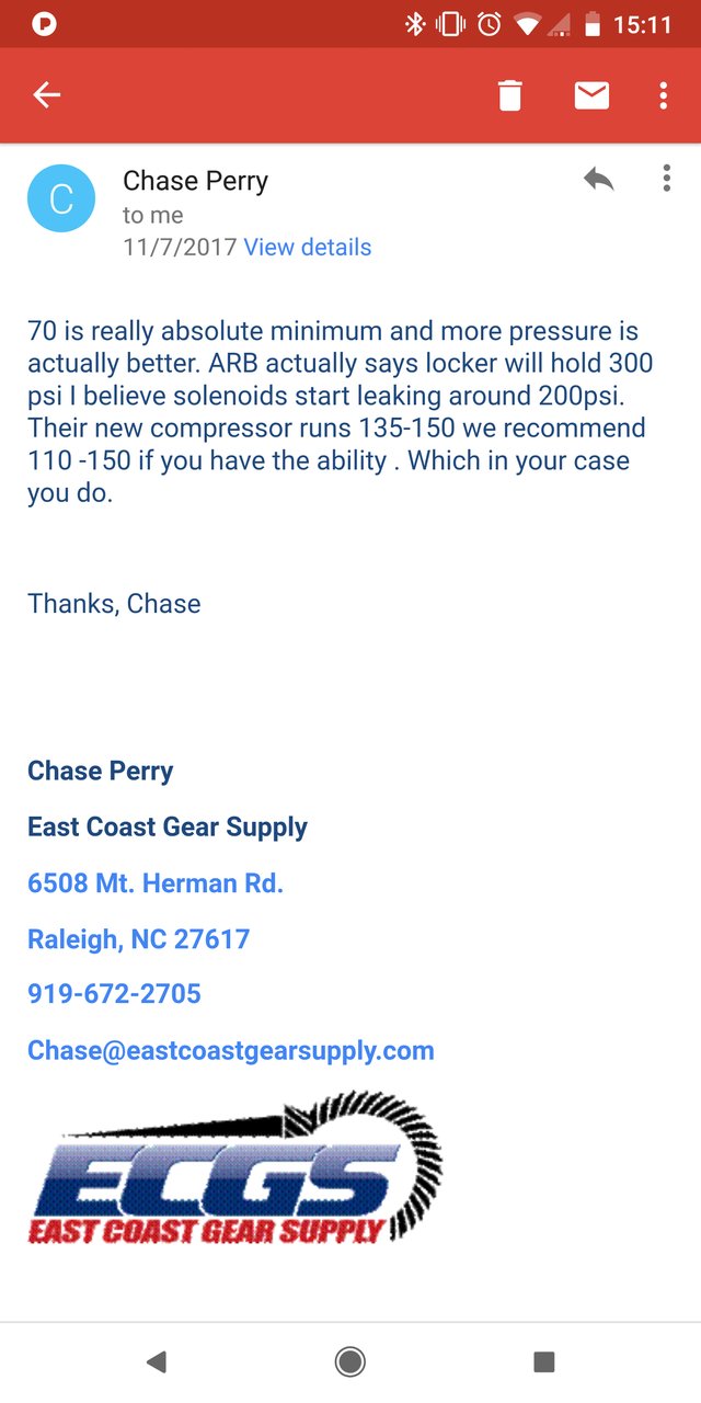

    Any reason for the regulator going to the tank? I'm pretty sure the ARB compressors have a pressure switch that shuts off at either 135 or 150psi anyway. If anything you would need a pressure regulator to your lockers which shouldn't have any more than 100psi to them.
    Personally, when I get lockers, I will be running:
    compressor (shut off @ 150psi) > water trap > tank
    tank > gauge
    tank > water trap > regulator @ 90psi > lockers
    tank > quick connect
    It seems like guys around here don't like this for some reason, but I leave my compressor on full time. It shuts itself off at 150psi, and I have no air leaks, so my tank is always full for when I want to air up tires or run lockers. I have the relay wired to keyed power, so the compressor can only turn on if the engine is running, leaving no risk of killing my battery. If something did happen, I have dual batteries, so my starter battery is protected anyway.
    I do have a compressor power switch, so I can shut it off if I need to, and if I was ever in a really big jam and needed to run the compressor with the truck off for whatever reason, I can either leave the key in the "run" position, or snip the wire and run it straight to battery. I drain any moisture from my tank once a month or so, but there is rarely much in there.

    I wasn’t sure if the compressor was regulated at all. So I figured out it in front of the tank to control it. I know for the lockers the solonoids and pressure switches will control the proper amount of air going to the lockers (if I understood correctly). So only needed for the tank I thought.
    Also I wanted to keep the two systems separate (tank and lockers). Figured with the manifold it would work and could separate it all. This way the tank doesn’t have to completely fill if I need to just switch the lockers on.
    Any issues with that? I like your method too, just didn’t want to have to fill the tank if I needed to run lockers.

    Totally get that, and the way you are doing it seems like how most people here run their setup. My tank is always full, so I have instant air, even without the compressor kicking on I could engage the lockers a few times. The way you have it, you will need to make sure you turn your compressor on every time before you engage your lockers.
    You shouldn't need a regulator to the tank, it can handle full volume from the compressor, no problems. The only reason you would need a regulator would be if you were running sensitive tools or something from your air tank, which I doubt would be a problem. And even then, the regulator would be installed after your tank, not before. I'm 95% sure that the ARB twin has it's own pressure shut off switch, so that shouldn't be a problem.

    FWIW last time I talked to ECGS they said that arb lockers are perfectly happy at 150 psi.
    mcharfauros, tacoma16 and Blackout14 like this.

    Fair enough. Seems like you can google ARB locker pressure and find an answer for anywhere between 70 - 150psi
