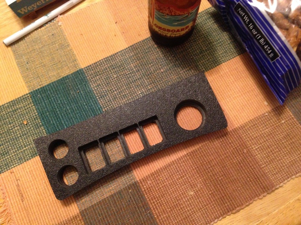

    Here's my OBA panel. It holds 2-1" pressure gauges, 4 small push switches, and a pressure regulator. Fits in front of the shifter, idea borrowed from Iggy's panels and adapted to my needs. Everything is centered based on drivers perspective. F9C122C4-85A3-418D-BCAC-A6263186561C_zps_985d634c32d84859f7a0fbcdd0346a6f3a069636.jpg
