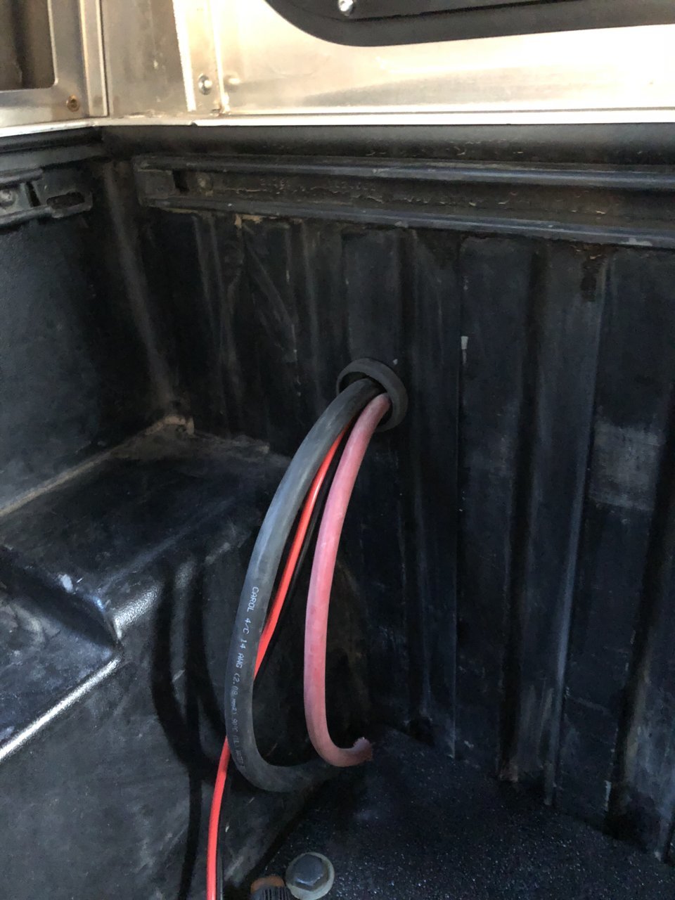

    07 LT 4x4 DCSB 6spd Vagabond
    Drifter wedge camper, Dual battery, OBA, ARB locker, 4.56 gears
    I used to have my compressor mounted in the cubby hole and it definitely is exposed to the elements. Mine got super muddy. Eventually ended up getting a Zenith compressor and mounted it in a toolbox, but now with the Vagabond Drifter, it'll go in one of the drawers I'm making. Starting to prewire it now
    Only way I recommend putting in the cubby area is in a custom weatherproof box that takes the place of the plastic OEM cubby
