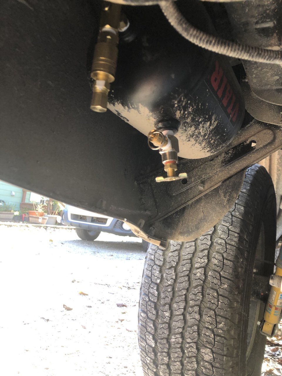

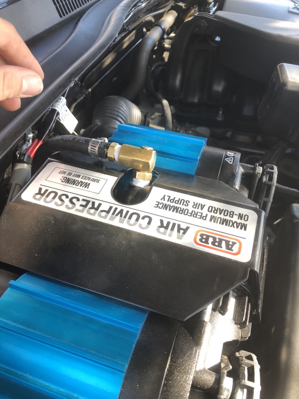

    Just finished up my OBA. It’s ARB twin compressor mounted on the Slee off-road bracket. Used some 1/4” NPT fittings from a local hardware store. They also has some high temp hose I could cut to length there, so picked up 20’ of that. Got it all plumbed up, put in a 1gallon viair tank, and 2 quickconnects. Overall the system is great, since the twin compressor has a shut off at 100psi I should never reach the full potential of the 150psi tank. So far I’ve used a impact just to see how it performs. After about 4 lugs the compressor kicked on but pressure was good to get the last two. It takes about 2 minutes to reach the 100psi for the compressor to kick off from empty system.

    The twin has an internal pressure switch of 150psi
