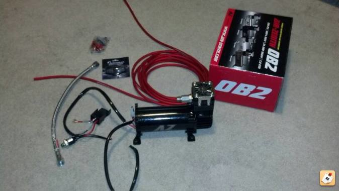

    Parts started arriving today.
    AirZenith OB2 Compressor
    Viair 165/200 PSI Sealed/30A pressure switch
    25' 4g power wire
    Waiting on my switches, tank, airline and some other stuff before I can figure out how I'm going to do it. The compressor is bigger and heavier than I had imagined so might have to go back to the drawing board on my original mounting plans.

  18. Jan 8, 2014 at 8:44 PM
    #178
    skygear
    skygear                    
    Nov 6, 2011
    #66558
    8,414
    Aaron. Compare the specs of that to the 400 series. Looks like that will fit nicely in the same spot mine were mounted in.
    Could always just lay on your back, hold the compressor by the motor and see if she fits 'dry' in the spot.
    I would remove the cubby hole for visual inspection.
    Mine were heavy too.

    #179
    AaronArf
    AaronArf Well-Known Member
    Nov 12, 2011
    #66926
    4,205
    Aaron
    VA Beach
    2023 LR OR DCSB
    I just got confirmation from AirZenith that upside down/veritical is OK for mounting and it won't effect my warranty. Will try to fit it up there, I'm still hopeful because that's going to be the easiest location but I dunno. Gonna test fit it this weekend when it warms up!
