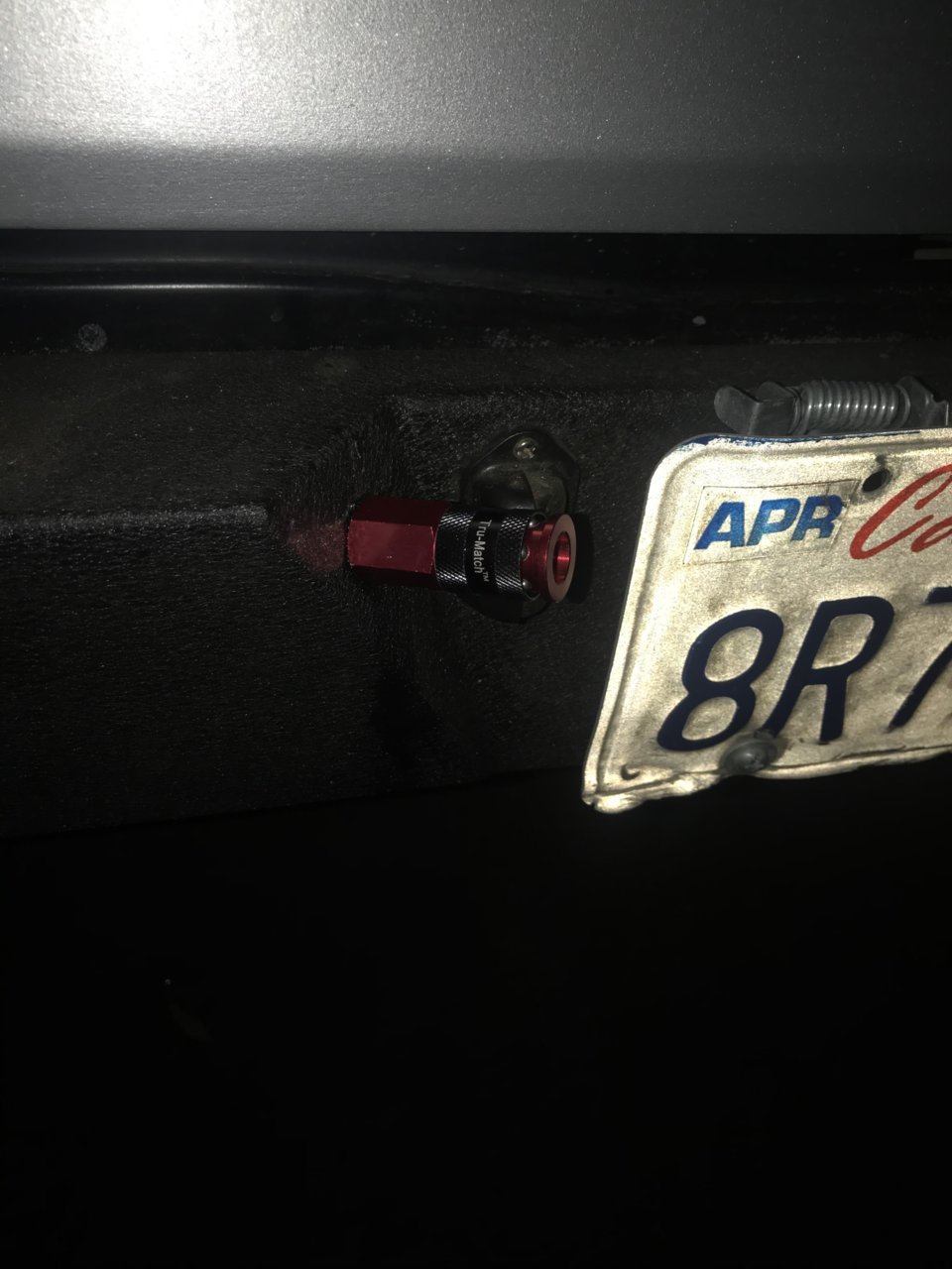

    Definitely do at least 16” of stainless to the manifold. Learned that the hard way.
    This is simply 1/4” Amflo hose and it works perfect
    Here’s the rear Qd I used about 30 feet worth

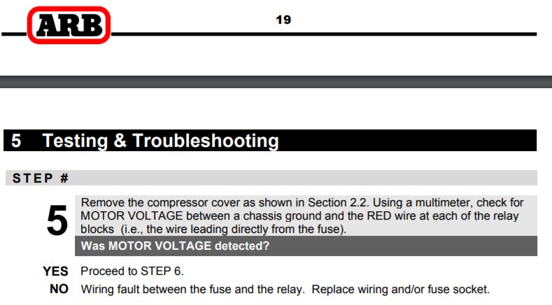

    Do you have the wiring diagram(install instructions)?

    Yes, but it does not show an exploded view of the compressor unit. And all the exploded views online don't show all the parts, including the relays.
    Now I find something on a Jeep forum where someone was having the same problem and he said something about "replacing one of the relays" so that sort of implies there is more than one.
    Guess I'm going to have to take it apart.

    "each of the relay blocks" seems to suggest 2 relays
