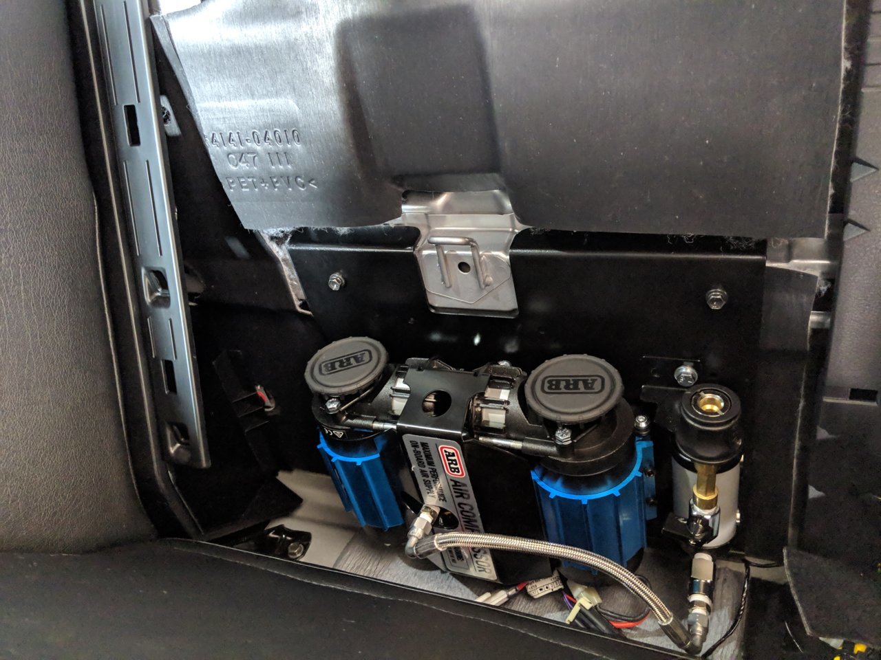

    I know I'm running dual ARBs, just curious really

  14. Mar 22, 2019 at 6:49 PM

    2,614
    Alex
    Minnesota
    2016 TRD OR 4X4 DCSB Slowsand, 2017 WRX WRB
    Any concerns with heat/noise with it in the cab? Install looks good.

    Do you have the ARB dual compressor?
    If so, do you have it mounted in the Slee bracket?
    If so, have you ever had one of the relays go bad?
    If so, it there a way to open up the compressor without uninstalling the whole thing?
    Thanks.

    I'd wager no

    Just going by the exploded view of the twin there are 4 screws that hold the center cover in place, all on the end opposite the black "ARB" compressor heads. The relays are under that cover at the same end as those screws. Check your harness plugs, fuses, and ground first as well as your switch fuse.

    I've been over a lot of that already.
    It started when I would flip the switch to turn the compressor off and it kept on running. After some trouble shooting I figured out that only one side was not shutting off. The other side worked fine.
    So I believe that either the troublesome side has it's relay stuck "on" or a pressure switch is not doing its job. Either way, I'm going to have to tear it apart. :(
