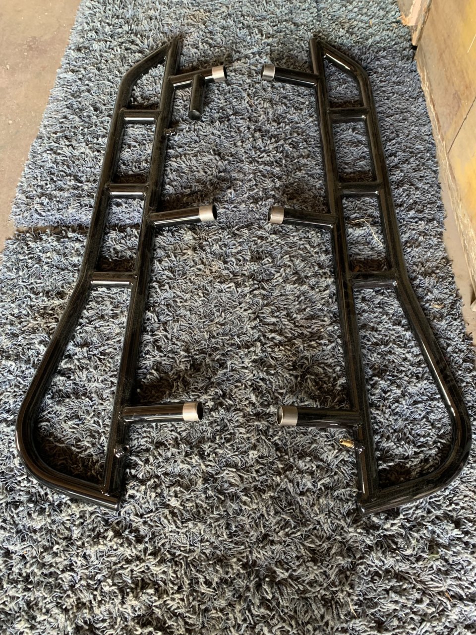

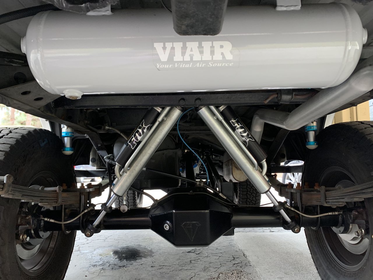

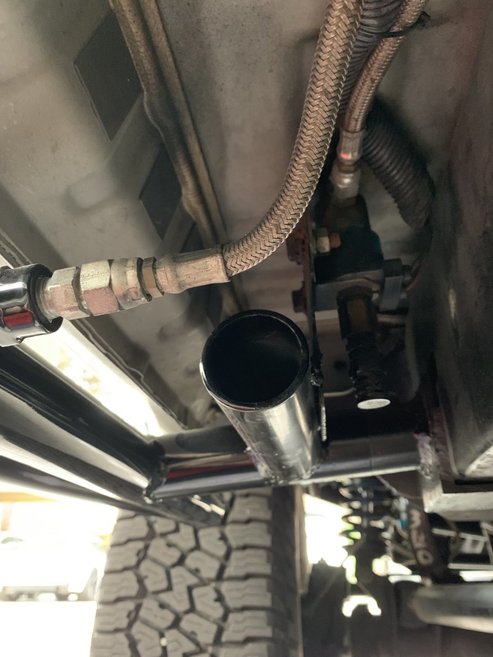

    So I recently updated the air capacity in that I cut off my old sliders and installed a set from Marlin Crawler. I welded on the kickers at my desired angle, drilled holes in the tubing and welded on threaded bungs to accept air fittings. I did have them powder coated also. Both are plumbed and now hold air.
    Prior to this, I'd relocated the rear shocks, which forced me to move the spare into the bed. The additional space allowed me to add a 2.5 gallon Viair tank. Not sure of the overall capacity but it's more than before.
    Also, these pics show the Peterbilt fan clutch switch. When shut off, the entire air system purges along with any condensation.

    To drain the condensation you need a purge at the low point of each storage tank otherwise your just bleeding off pressure but leaving the moisture behind.

    The solenoid is at the lowest point for two locations. I won’t add a valve to the PS slider.
    Honestly, these pieces are sacrificial and should they rust out before I damage them, so be it.
  19. May 6, 2019 at 5:17 PM
    #1859
