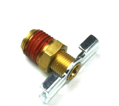

    Sorry. I forgot to include the picture (fixed). I'm looking for 1/4".

    You can try Ace, they had one in Brass so they may have some in stainless

    Nylon ball valve is another option but if it's that exposed you might want to consider a cover of some kind to at least keep direct spray away from it. Road debris will also erode the tank paint and then it will start to corrode too. You might want to reconsider tank location, my 2 gal is stuffed into the bedwall in front of the rear passenger tire. It's a tight fit but not nearly as exposed as anywhere behind the axle or hanging from the bed. Another option is 2 smaller tanks can be located in more places than a single large one. Good luck, salt is a bitch.
