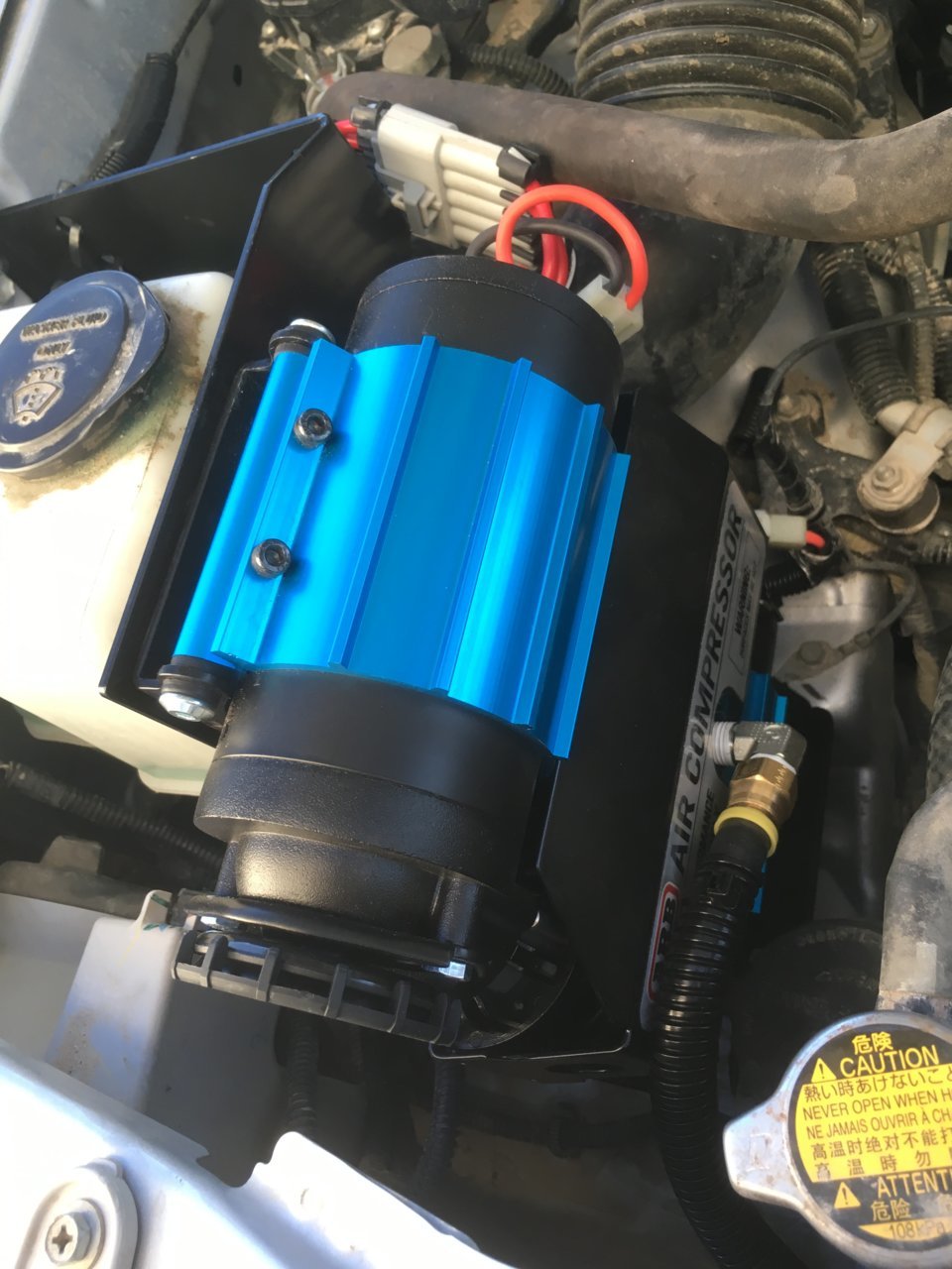

    That would be my guess.

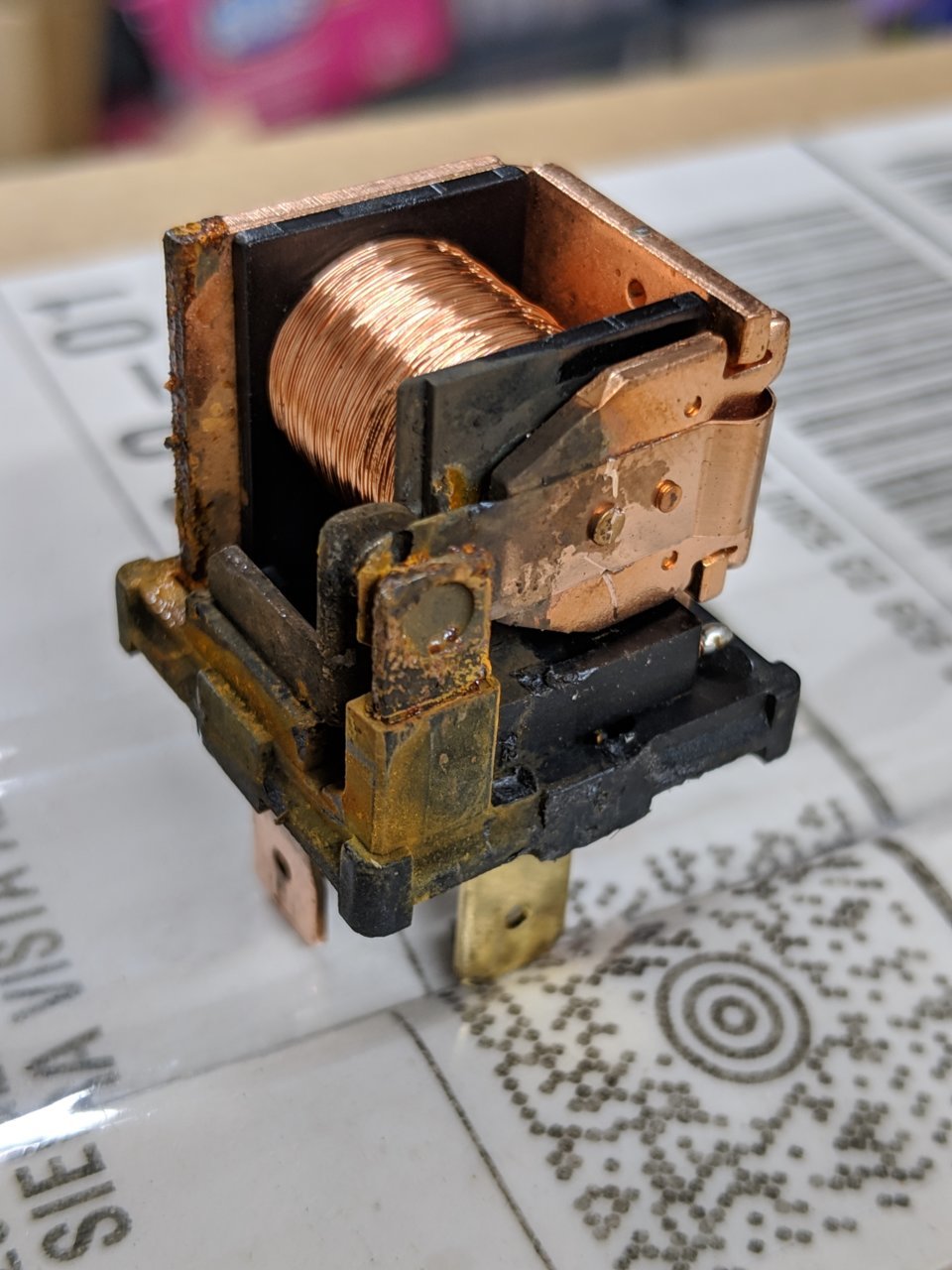

    Relay. Probably go water in it and now its corroded.
    Posted this image of my relay a few weeks ago. I got lucky and instead of never turning off mine just never turned on.

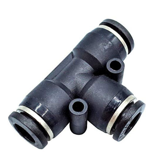

    This may have been asked before, and I apologize if it has been but is there a way (or a special tool) that can be used to to remove the tubing from theses kinds of fittings? TIA

    I'm pretty sure you just push the collar back and then pull the hose out.

    Tried that. Couldn't get it to unplug.

    Try slipping a 1/4" open end wrench over the tube and use that to compress the collar fully before trying to pull the tubing out.

    Might need to push the tube in slightly as well to break it free of the tangs in the fitting. The collar releases the tension but they frequently stick in the hose.
