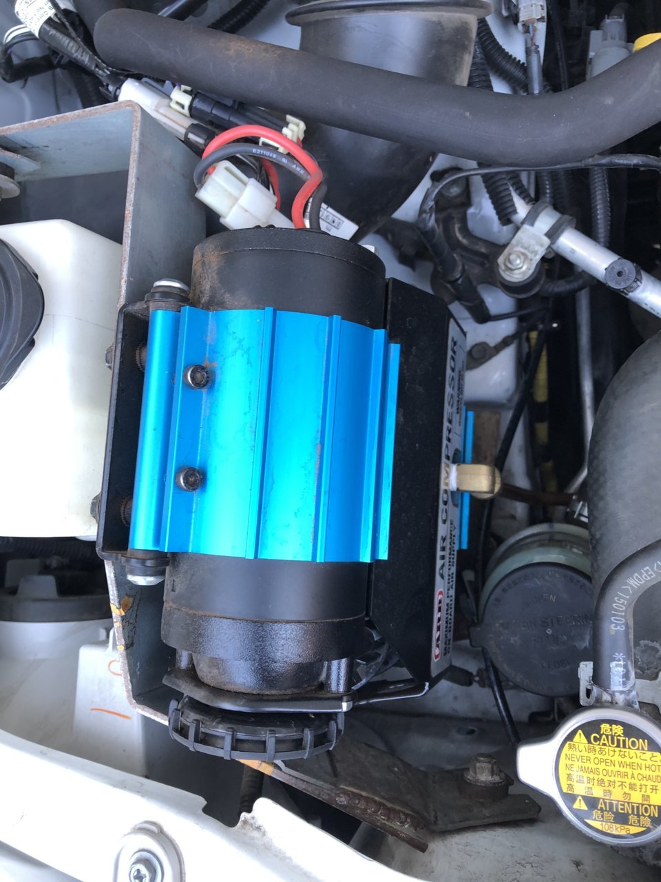

    Why does my ARB Dual Compressor keep blowing fuses? This morning it wouldn't start and both 40amp fuses were blown. This has been happening about once a week now.

    Maybe a bad unit? New install or been around the block a few times? I've had mine in for four years now. Used it twice yesterday to reinflate all four tires 20 to 40lbs with no issues.

    I've had it a couple years. I use it more or less all the time to keep my air tank full to run my air horns.

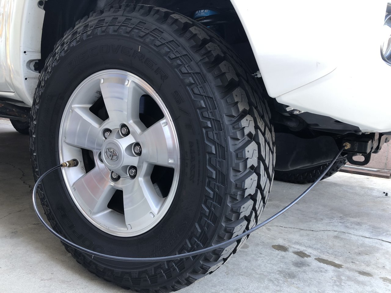

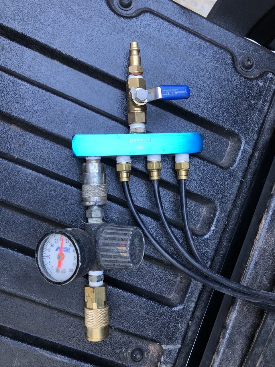

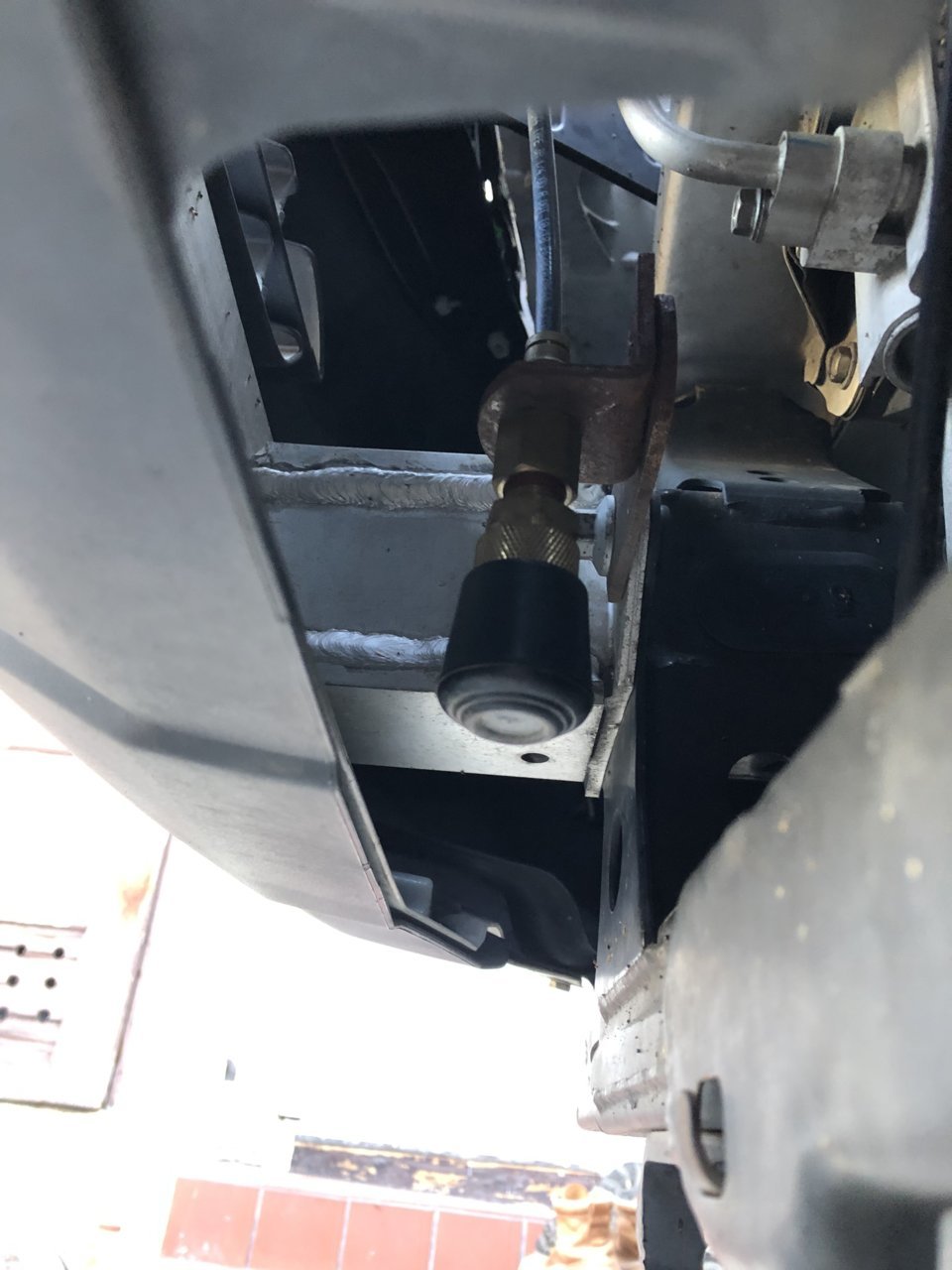

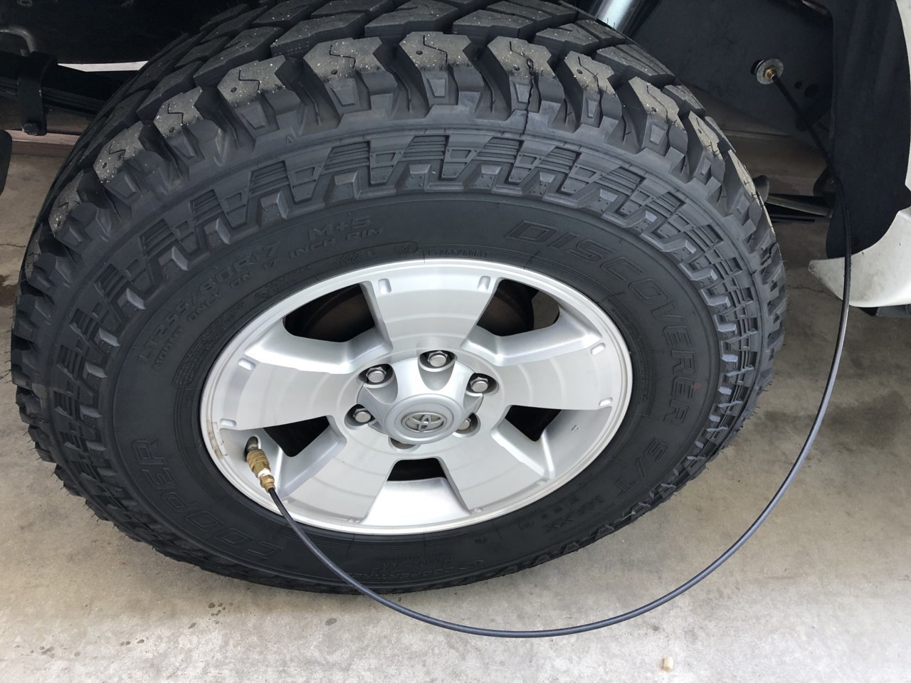

    I basically can air up/down all four tires at the same time and to the same pressure or different pressure f/r. The front is supply with one line and y in the front cross member and the rear has their own line. Used ptc connections for quick setups.
    I also have a 3 gallon air tank not shown so airing up is very quick
    Basically I didn’t like the twist on tire deflators since pressure won’t match at each corner and this help with airing up so why not. Parts were pretty cheap to
