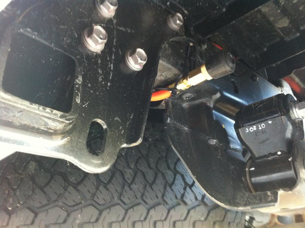

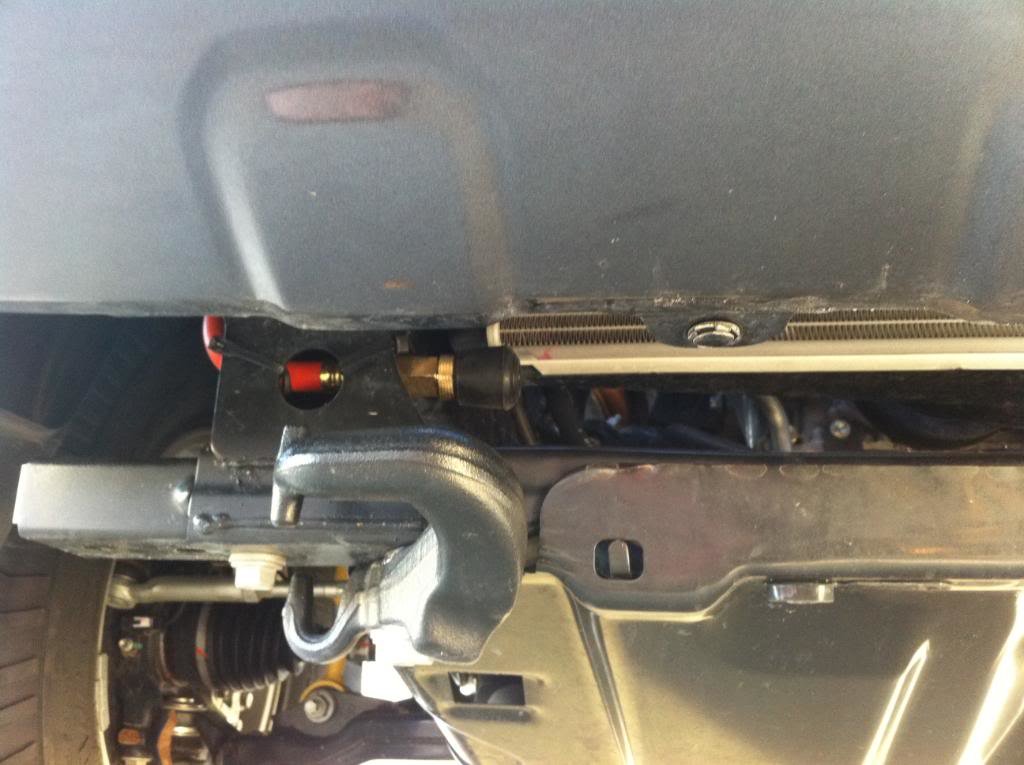

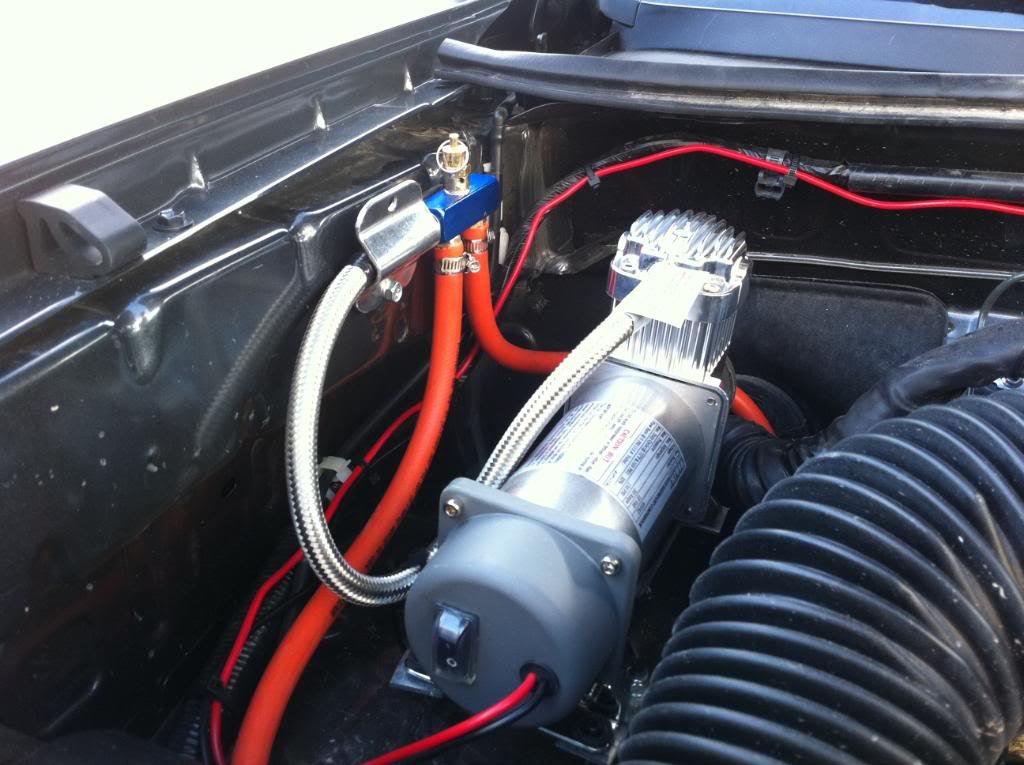

    So I finished the install today. As I mentioned, the Viair 400H is in the open space near the windshield on the passenger side.
    The leader runs into a manifold ($2 from Harbor Freight!) where I've installed a 115psi safety valve (since I don't have a regulator or a tank and am likely to forget and run it without an attachment...). I used the unused part of my CB antenna bracket to hold the manifold in place. I think I'll make a better bracket later.
    From there it branches into the two orange lines - one to the front under the bumper and above the skid...
    ...and the other to the rear, mounted to the frame above the hitch.
    This way they're all out of the way and won't get ripped off if I catch the truck on something. I added a rubber chair leg cap to each QD to keep dust/mud out of them, too. So now I can air up without scratching the truck with the coil hose and I have easy access for helping fellow drivers.
