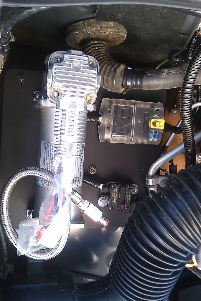

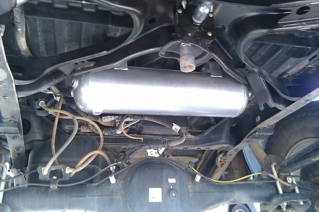

    I went with this one http://www.viaircorp.com/OffRoad/10007.html because it has the lowest amp draw and its constant duty. It will be nice to run air tools on the trail if necessary. I've seen the compresser mounted in the cubby hole in the bed and the air tank right in front of the bumper. I put my compresser under the hood and the air tank right behind the axle since the spare will be in the bed. I don't know how well the system works yet since I'm still putting it together.
    I have more pics in my build.
