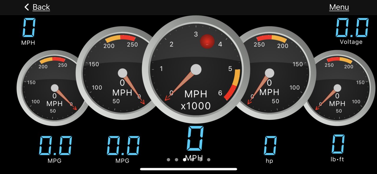

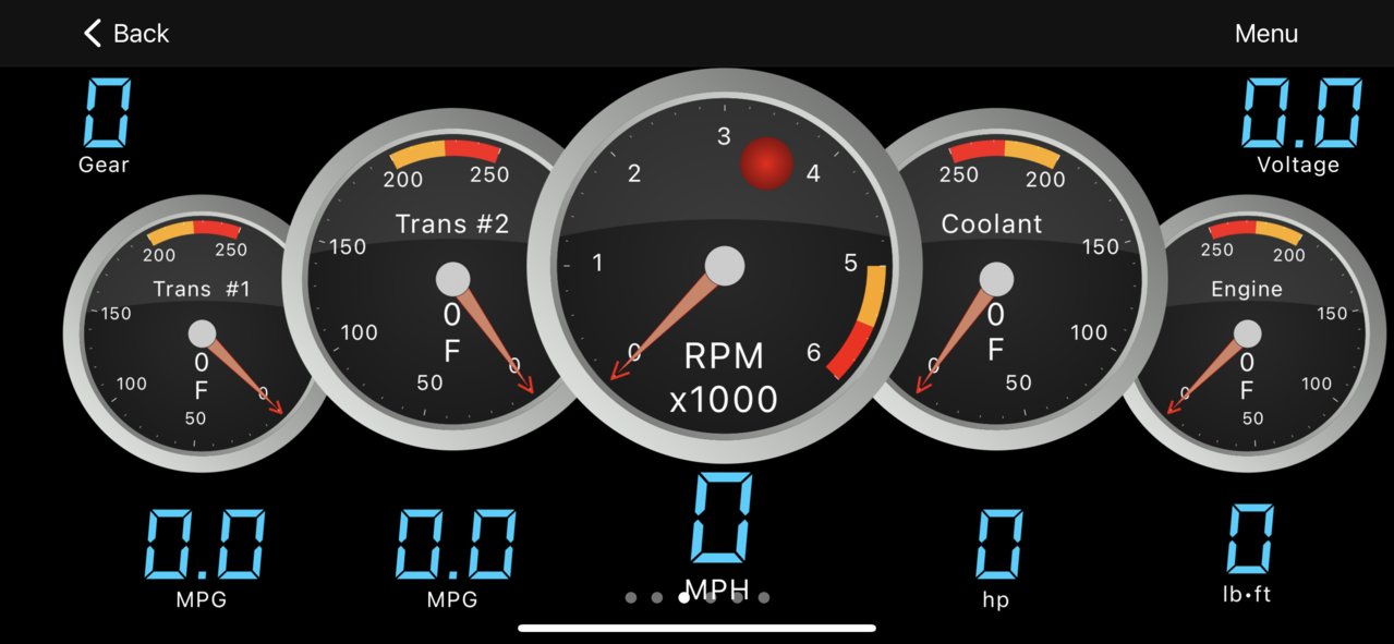

    Man, idk what I’m doing wrong, but when I import your dashboard all the heading read MPH and when I go to change them. MPH stays and the name I change it to overlays on it.

    What version are you running? I wonder if that might be an issue. I can check to make sure I’m on the latest, and export again.

    PS. There’s a title, and then there’s the units. I have title empty I believe. I think I may have run across that problem myself once.

    Here is my towing one

    Seems like we all go for the same PIDs.

    Very clean. I know with my eyes I really need the ranges. Gets a little hard to read actual numbers on a gauge.

    I pulled your dashboard down and looked at it in an editor, not text :D
    I imported it to my phone (I used iMazing to copy to the ODBFusion/Documents folder on the phone), the import process is amazingly counter intuitive (select step, set, go back to settings, next step is available ... ) you'd think some 'next' buttons might show up at some point.
    To refer to @MarshRiver's comment, your dashboard showed up on my phone as expected (mine is a 12 pro max, in case that might matter).

    Agreed, checking your settings and exiting is what triggers the import or export. It’s a bit counterintuitive.

    So did the settings come in correct? What about gauge placement since you’re on a max? I haven’t quite sorted out placement rules. It seems like sometimes it’s from center, and sometimes from an edge.

    No apparent issue on the settings or placement.

    same problem here. FFS

    Figured it out. :anonymous:
    Updated the app and redownloaded the Toyota PIDs.
