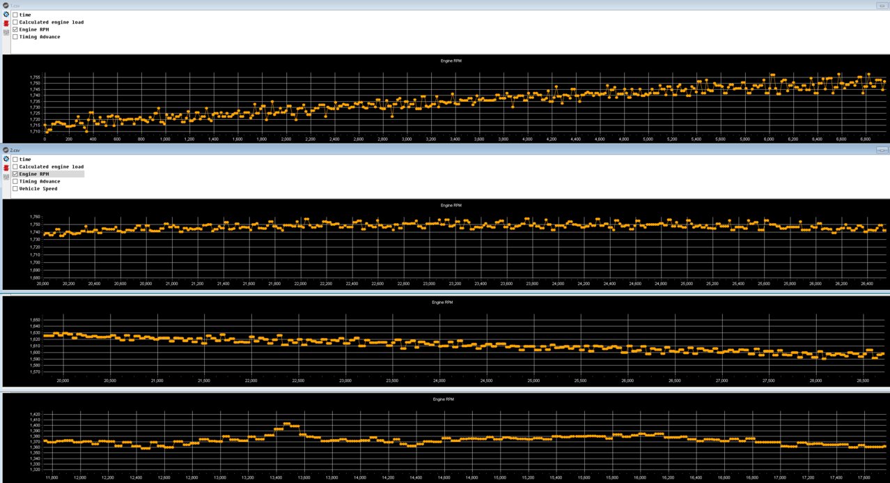

    Yeah. That was problematic. On both my ancient 7yr old adapter and the guy's new VeePeak BT 4.0 adapter, the fastest that we got was a pathetic 1/sec. We were trying to diagnose an estimated 10hz vibration. Both adapters did not puke when we tried the higher data rate settings, but the logs were still 1/sec.
    Regardless, getting a dashboard set up easily for this new user and getting info out, it was very helpful. We were also able to visually monitor the SLU and TC Locked states in person, which I believe was enough to rule out a TC issue. :cheers:
    The problem is that we are now stumped. Tried a few good suggestions like needle bearing diag, deleting SLU, and a few other things. Either no change to the vibes or made them intolerably worse. Fully stock 2021 that I'm leaning in on a bad MAF or ETB. I've seen a few other post about this Stutter / Rumble Strip vibration on 2021s.
    Considering these are about 6sec to 7sec slices, that is just fucked:

    Try this: generate a dashboard that *only* has the items you want to log. Even if you are only logging 3 of 10 dashboard items, the refresh rate is a function of how many PIDs are on the dashboard.

    I got crossed up with the Fusion thing and vF not having the TC PIDs, so TS was completely forgotten until I was leaving. Just a brain fart. But, the log posted above was from vF. It is logging at about 10hz. That was Version 1.2.9.9.4. 1.2.9.9.5 dropped when I got home that day.

    If that was 10hz, I don’t think OBDFusion is going to match that. Even with low dash widget counts.
