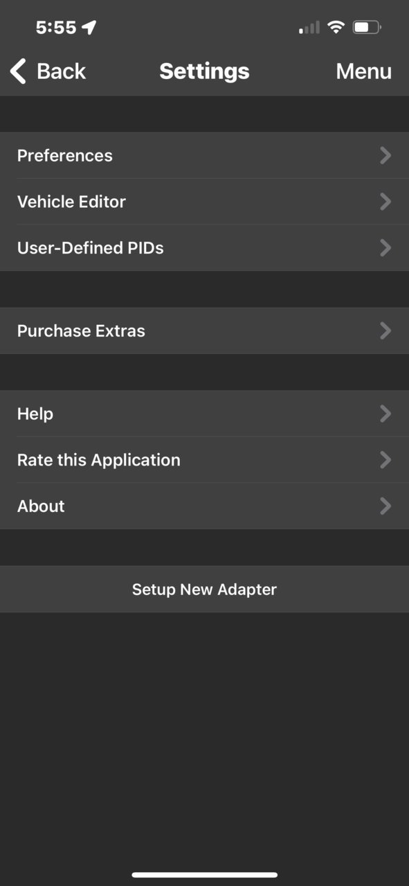

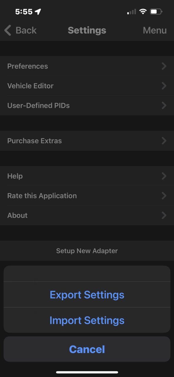

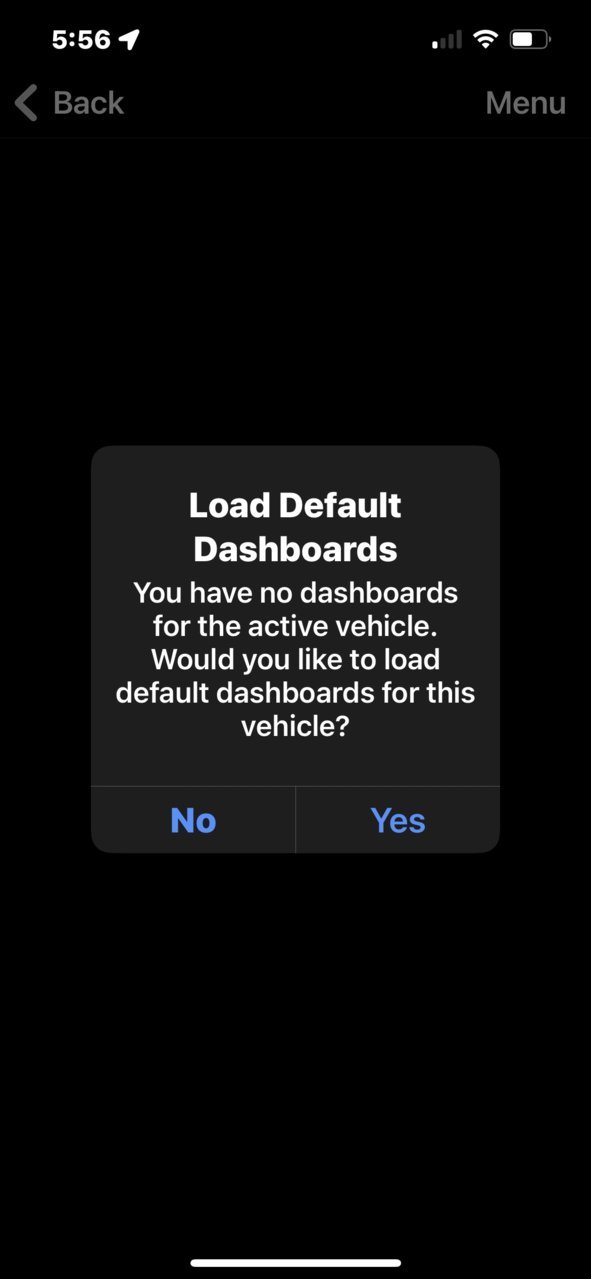

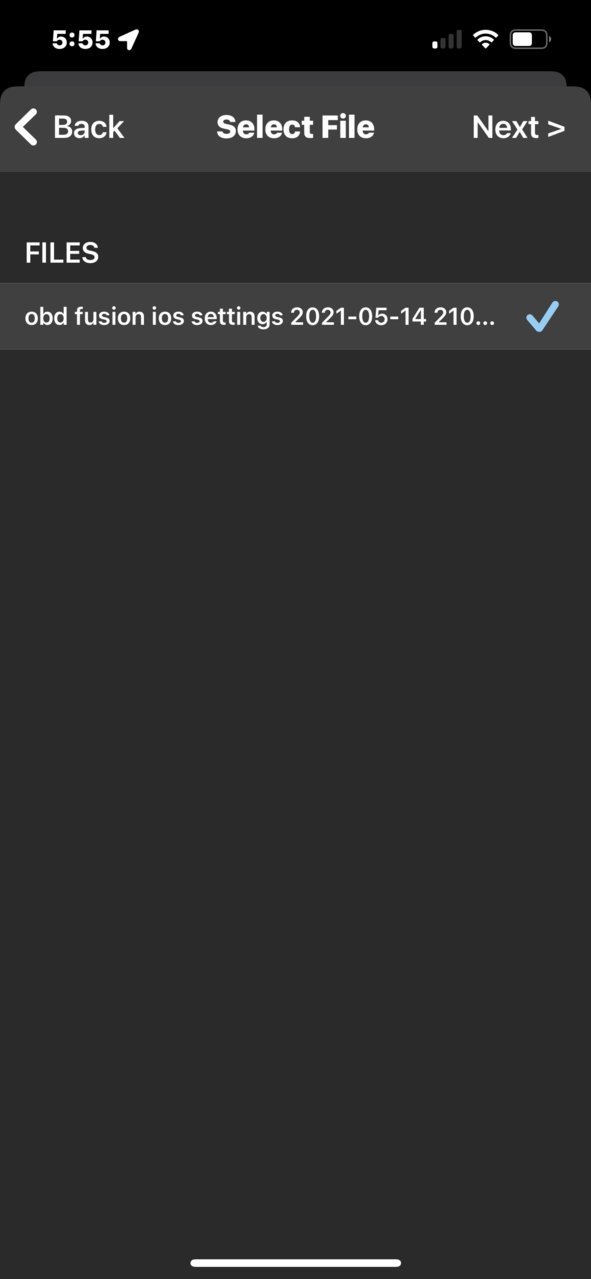

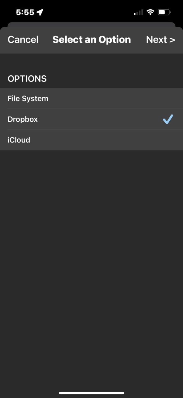

    Here's what happens...
    I go to Settings...and tap Preferences...
    I then tap Menu
    Then I tap Import Settings
    And click Dropbox
    I choose the file I want with the dashboard I want to use
    Then I press Next
    And then I press Next again
    After I back out and look for dashboards, it tells me I have none, so I reload the default dashboards and there is no imported dashboard
    Any idea what I did wrong?

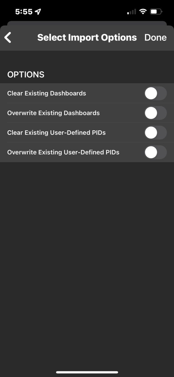

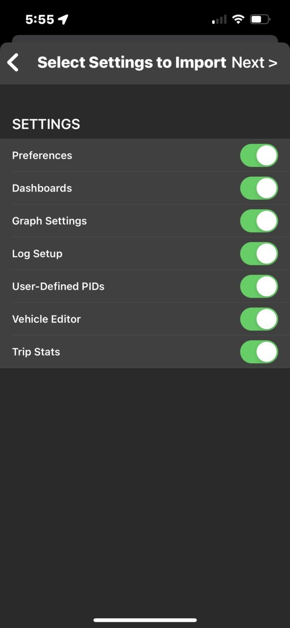

    I check all the checkmarks on the import setting screen with the done button. It always worked for me that way

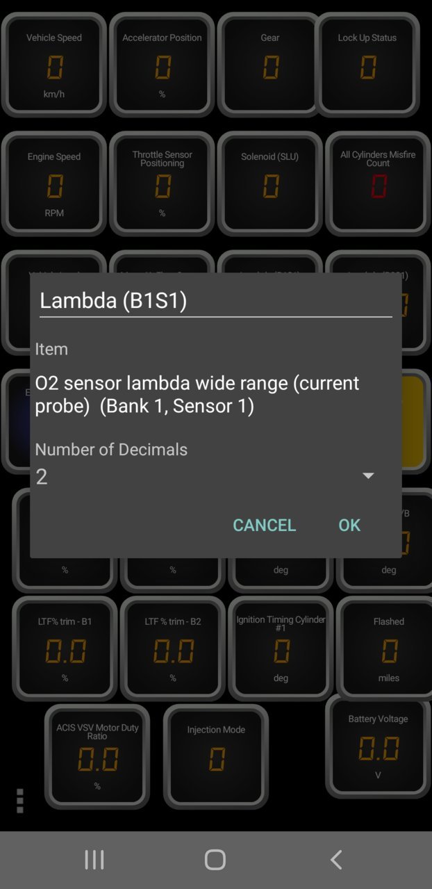

    What PID are you guys using for air fuel ratio? The "Air-Fuel Ratio" and "A/F Actual" don't seem to give accurate readings.

    I've been using this for both banks

    Try selecting the ‘overwrite existing dashboards’ option.
    Also, I *tend* to only import dashboards and not all the other options.
    Where are you getting your file from? Same version and Apple/android?

    Ok that seems to be working well. I read up on lambda a bit and it makes sense.
    Though now both the lambda value and the A/F Actual seem to be telling me that I am running lean on WOT. Previously the A/F Actual was reading over 18 and the lambda is reading 1.26 during WOT. That is equivalent to 18.5 AFR. That seems hard to believe it is running that lean.
    What values of lambda are you guys seeing during WOT?

    18 or 1.23 is a fuel cut off.

    Interesting. That makes me think the reading is wrong. During the WOT pull it accelerates very strongly and the engine doesn't run rough.

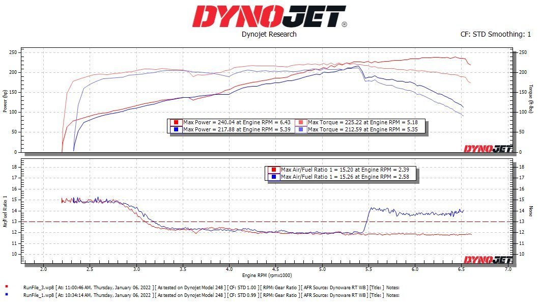

    Fusion is slow to see parameters in the real time. Enable login and hold wot for a few sec to see the trend .
    Here is the example of afr( from KDMAX thread)

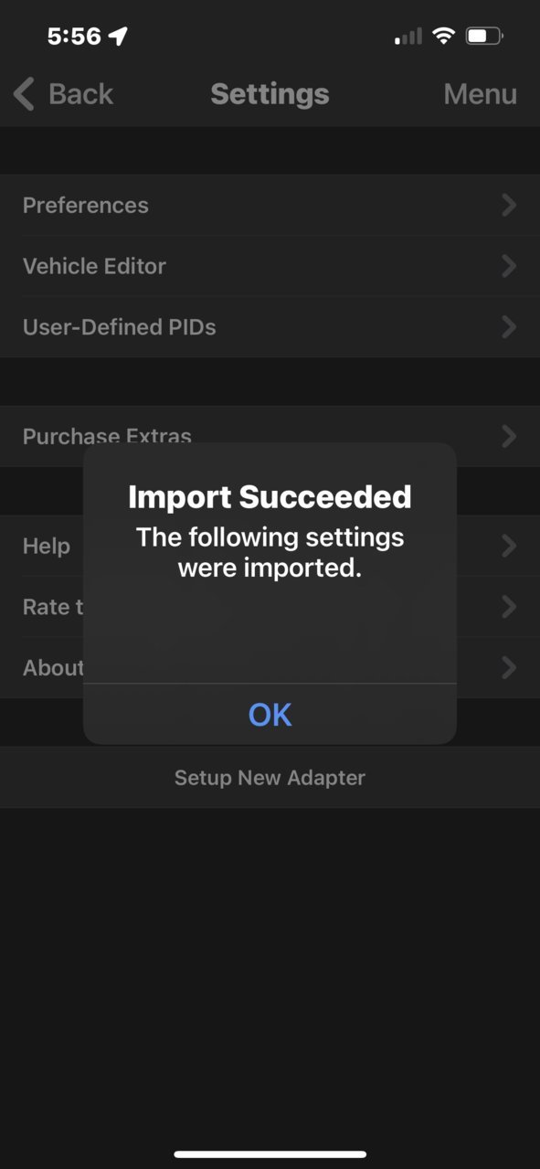

    I'm having the same issue as @SpyGoat , and tried both final options, new dashboard is not loading.
    Note: I am on latest iOS,, (14.6 I think?) And I am trying to use your dashboard in your first post. I see it's only been updated to iOS 12, maybe that's the issue? I don't see any newer options.
    Thanks for your help!

    I still have that one. It’s a little messy because as the iOS upgrades have happened, things have shifted around. Let me see if I can update/export with a new file and post back here once done.
    I do think there were occasional breaks with updates.

    Thanks, I still can’t get it to work, I’ll try again tomorrow. So far I tried moving the download from Google Drove to Dropbox since that’s where the app points to.

    Same here, have had no luck. iPhone 13 Pro, latest iOS, etc etc.

    I’ll see if I can delete all my dashboards and import from this file. Will report back.
