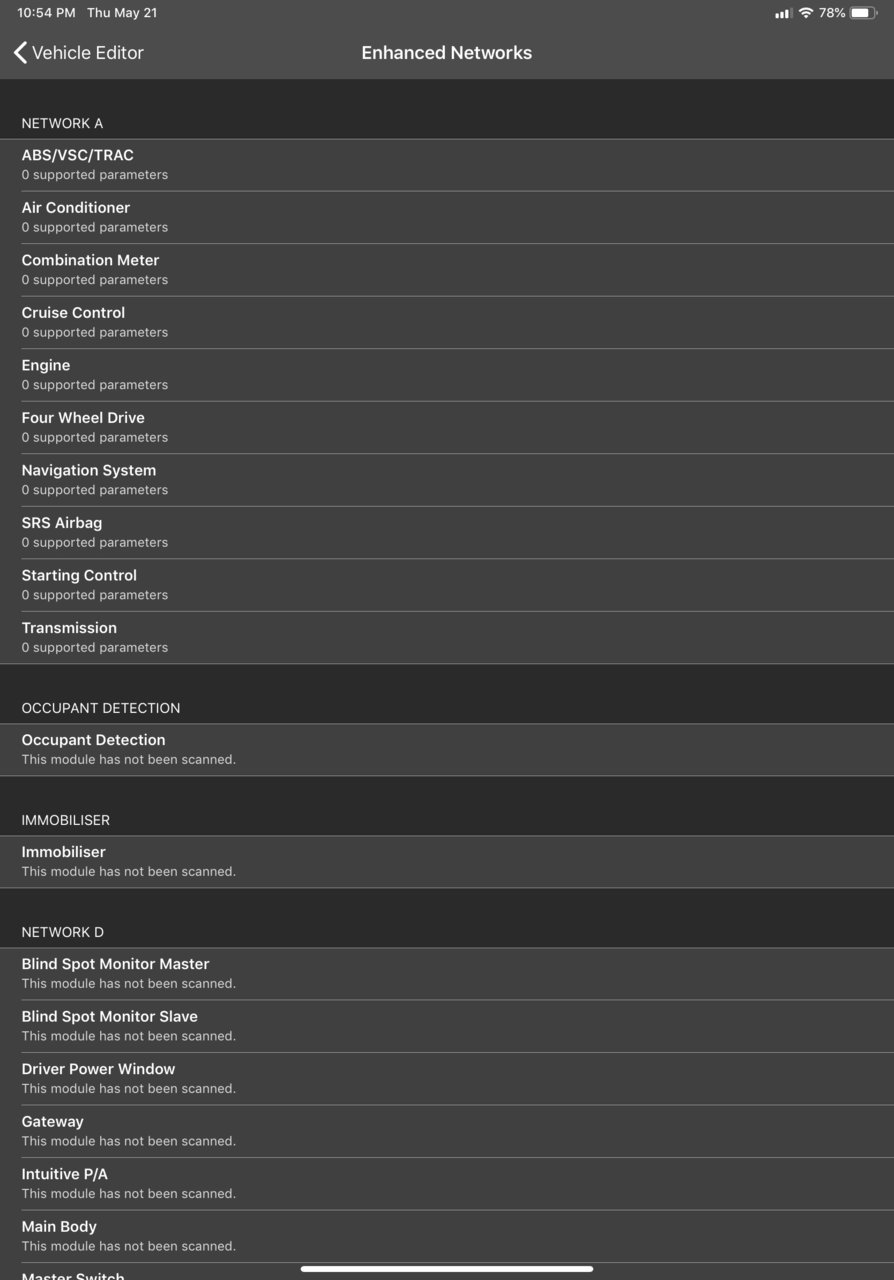

    Check your Vehicle editor setup for enhanced network

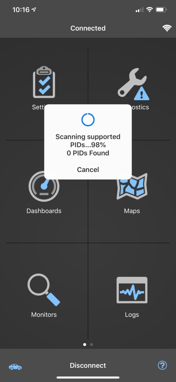

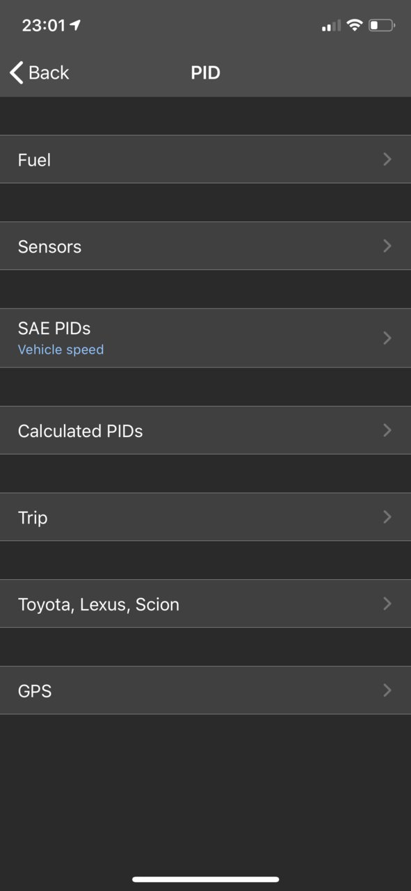

    I tried and tried, just can't get it to work. In fact, when I connect to my truck, I don't even see the "Toyota/Lexus/Scion" option. During the initial search to add my truck to the app, it search a long time (to 100%) but find 0 supported PIDs. I guess that is the problem. But I don't know how to fix it. I tried with my iPhone and iPad, same problem. :<

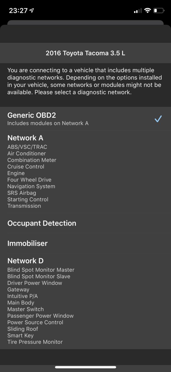

    When I connect mine I used the generic OBD...sounds like you might be clicking on Network D.

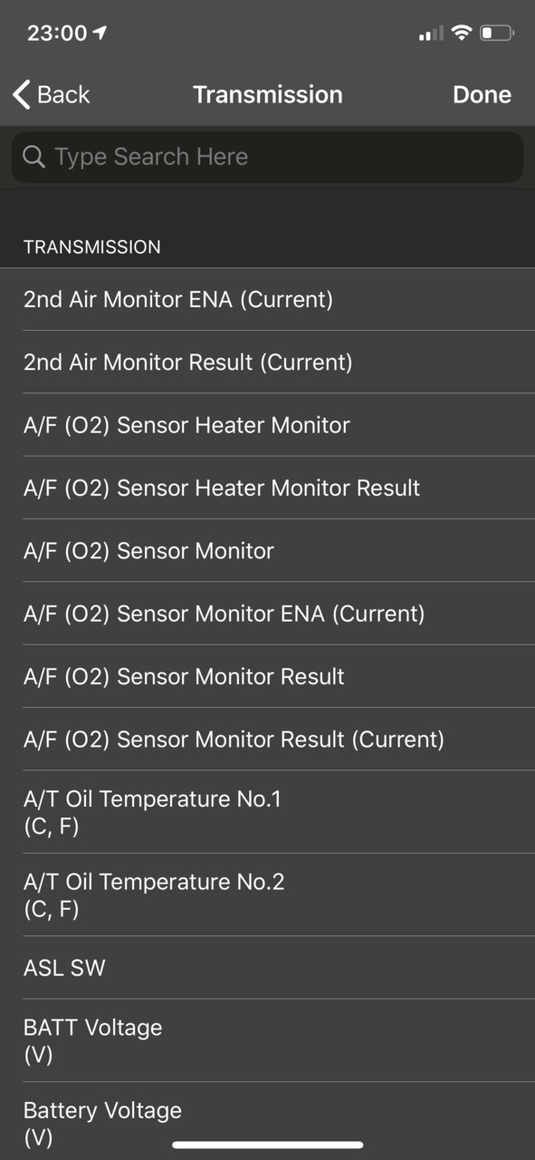

    What’s the difference between ‘at oil temp 1’ and 2?
  11. May 21, 2020 at 9:27 PM
    #31
    SearArtist
    SearArtist GX poor
    Jan 5, 2016
    #174151
    18,973
    NC
    GX470 & GX460
    Things
    1 is the pan temp and 2 is the torque converter, IIRC

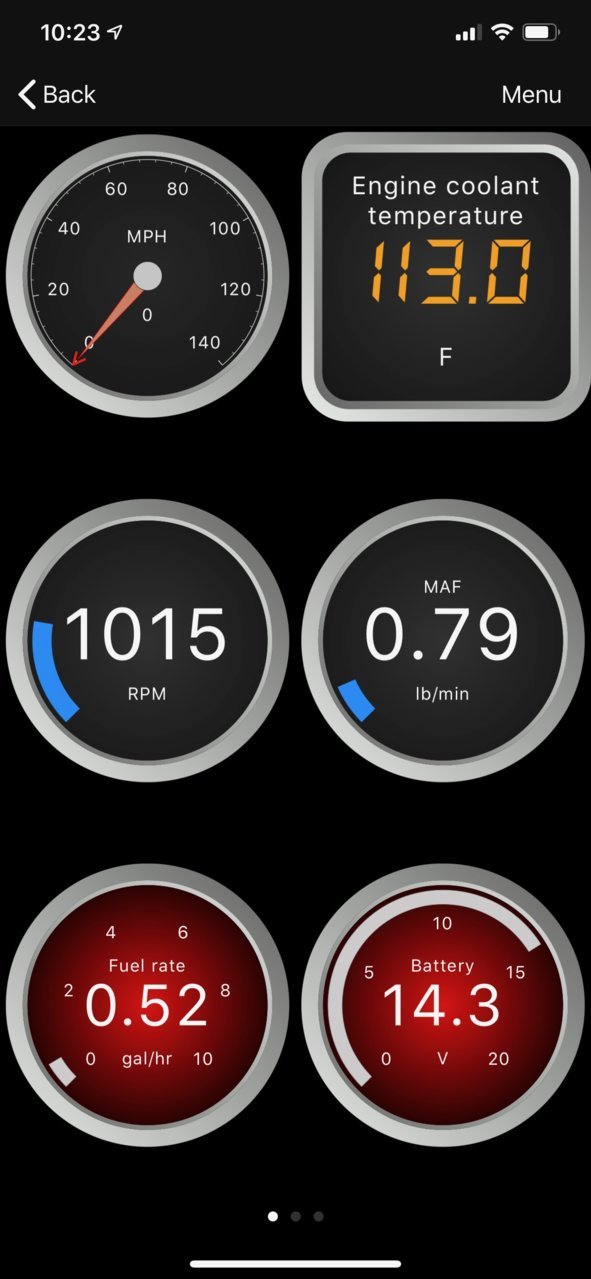

    First of all, I want to thank everybody, especially SearArtist and Vlady, for their detailed and helpful suggestions. I am officially frustrated and baffled. I tried all the methods: ignition mode without car running, car running, "Generic OBD2", or "Network A". Nothing works. I found exactly 0 supported PID every time.
    I can still read basic information:
    Just no enhanced information.
    The most frustrating thing is that I have a 2014 Sienna XLE, which was when I bought this setup the OBD2 adaptor and OBD Fusion app. It works no problem with my Sienna at the time and still today. I can clearly see all "Network A" PID options when I tried to add display:

    76
    2016 Tacoma Limited
    This is actually quite frustrating. Turns out it is just my cheap adapter stopped working. I bought a new one (still bluetooth; I don't like WiFI version because I want to keep my internet connection when I am reading the codes, so that I can do some quick searches to find out what the codes mean) for $45 and has been working fine:
