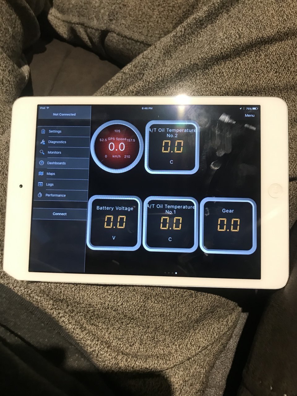

    Anyone know a way to hide the menu bar on the side of iPad minis when you turn sideways?
