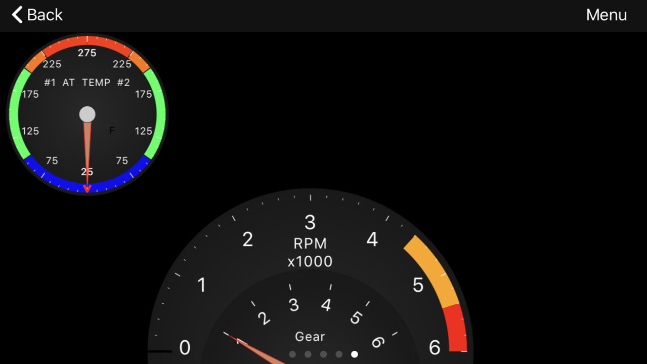

    Seems I'm keeping this thread going tonight. Got the nice dual ring setup for TC lock status as a solid ring, and the gear status inside that. One thing I noticed doing some around town driving, is that the TC is rarely locked.
    Here's what I'm tinkering with just to get a hang of what you can do outside of the standard designs. Dual Transmission temps, one clockwise and one counterclockwise on the same gauge. Triple gauge down below. RPM on the outer ring with a 'fill' rather than needle. Current gear with a needle. TC Lock status as a green band around the current gear dial (concentric ring).

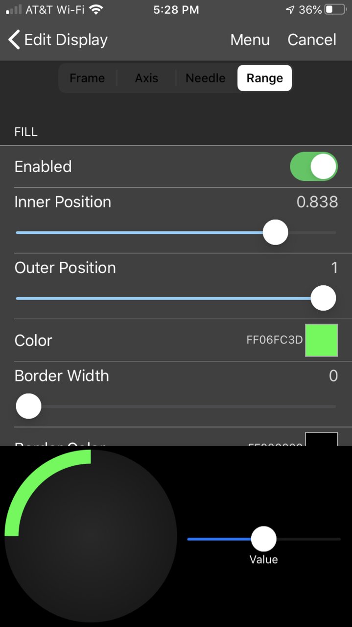

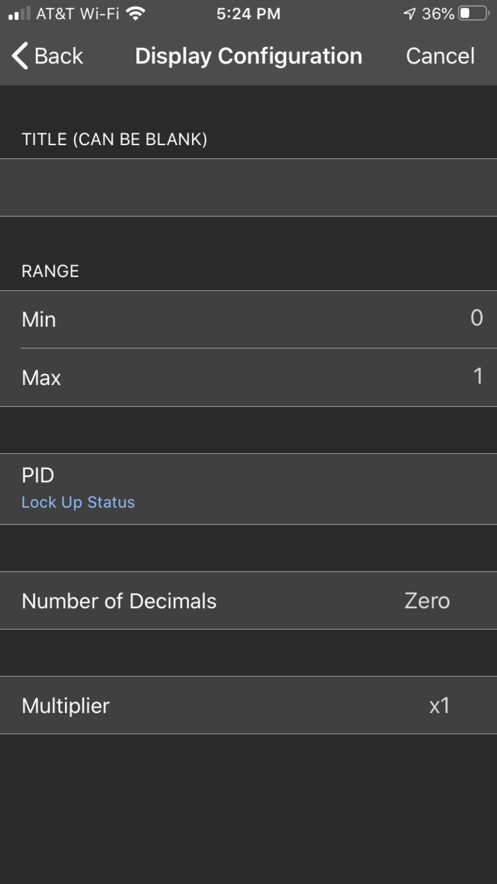

    Also, can someone do a step by step on getting the torque converter lockup to display as a colored ring around the gear indicator? I know it was mentioned earlier in the thread but I'm old and slow and haven't been able to figure it out. :notsure:
  13. Jul 15, 2020 at 3:23 PM
    #213
    RushT
    RushT Amateur Everythingist
    Dec 10, 2017
    #238171
    5,673
    North Texas
    '18 DCSB TRDOR Inferno
    I haven't looked at TPMS, but might do so now. For the colored ring... you need to create an analog gauge, tie it to the torque converter status, and set the range appropriately. It's going to be a separate gauge from the one used to report the actual gear. I'll see if I can grab some screenshots for you.

    Here’s something that might help. Keep in mind that mine's designed to do a half ring.
