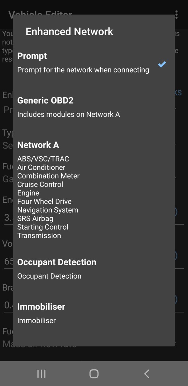

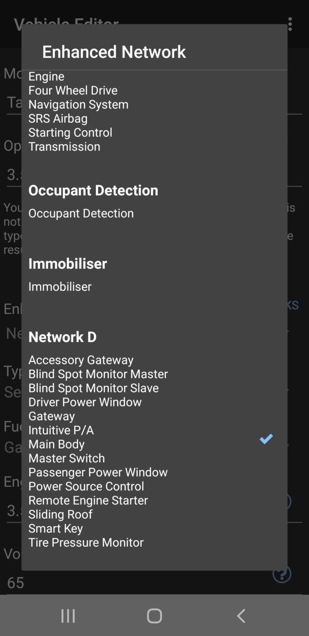

    You only can read tpms info if you are connected to network D.
    Go to Vehicle settings and select Promp for Network when connected .
    Select Network D and add PIDs.

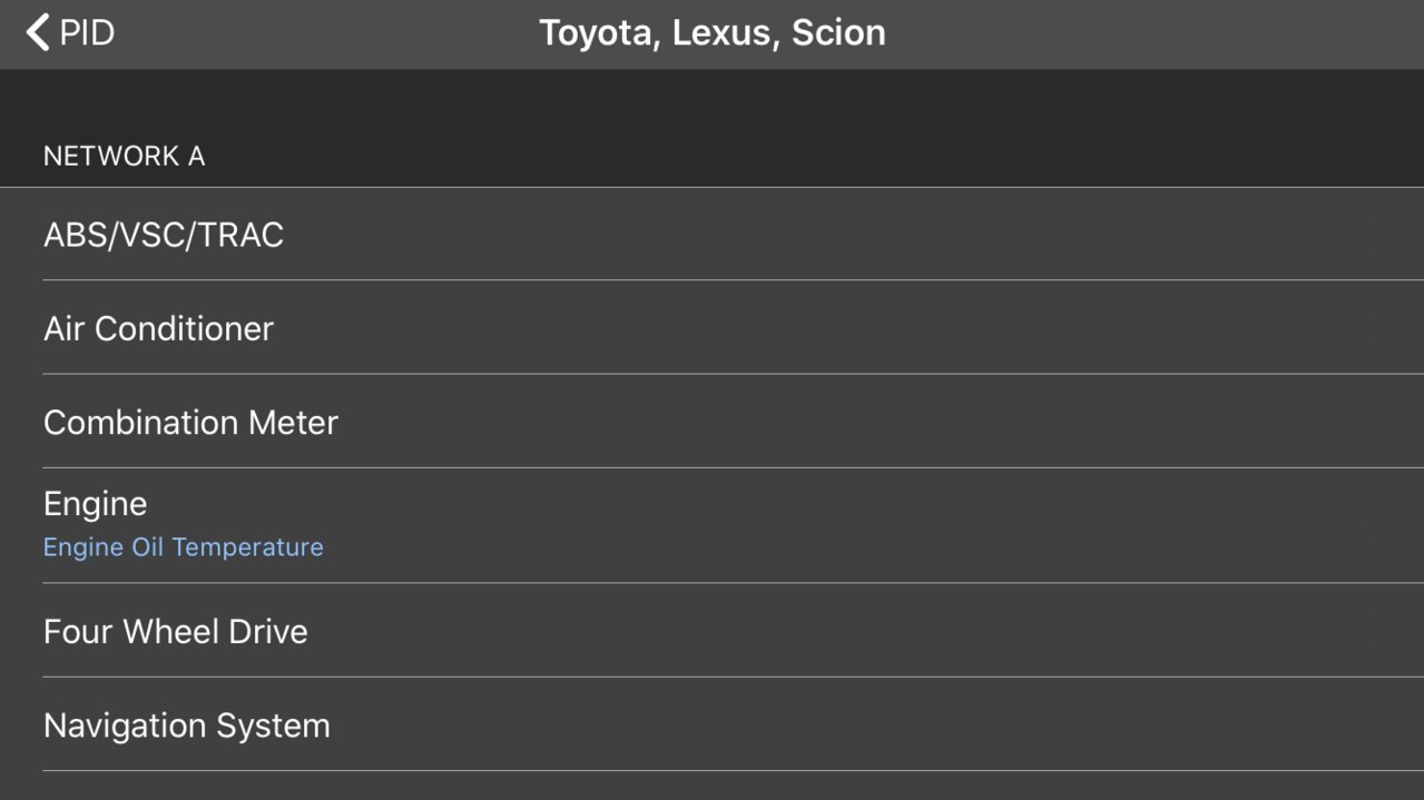

    I seem to be having issues with No Pids showing up under Network A. Ive purchased the appropriate Toyota pack and it shows that Ive purchased it, but when I go to add a display, nothing shows up under Network A. Anyone have this issue before?

    Have you gone through the process of scanning? I think you have to let it do its 3-5 minute thingy to confirm all the pids from the truck. You have to be connected to do this.

    Yah ive done that a couple times. Its weird because it showed up after the first time i scanned it, then the pids disappeared

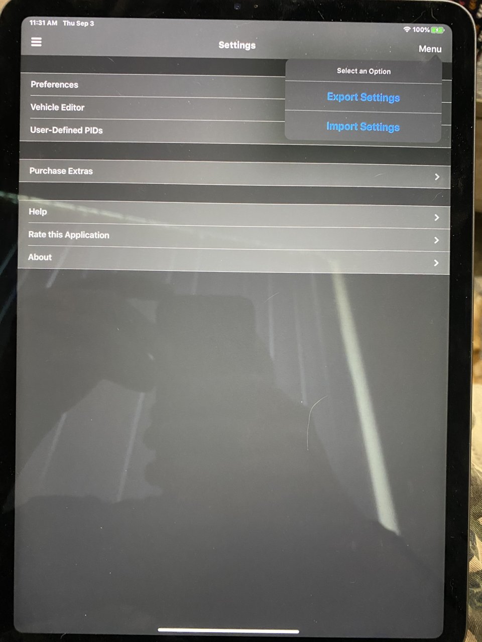

    Are you guys creating these intricate dashboards on your phones? I would really like to create a dashboard on my big computer monitors and then export/import to my truck’s tablet...

    I wish you could export a dashboard. I gave up on painting one.

    Oh you can...
    I downloaded a few from other sites.

    In OBD Fusion app?

    Yea, upper right corner under menu.

    Are they shareable? What other sites?

    I see afew posts before here here that files from Fusion can be exported . Any chance you could/would share the dash you made . I see it as a awesome towing dash .

    You bet! Let me get an export done and I’ll pm you the link or file. You’ll need to configure your OBD to connect to a Dropbox. Dropbox is the import export vehicle. Once exported, you can share it around. But it has to be in the linked Dropbox to import.
