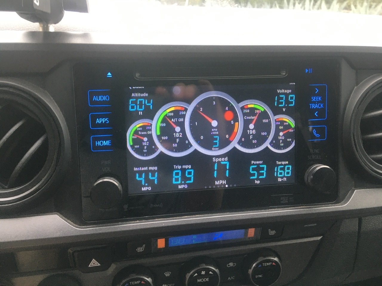

    I chose the OBDLink MX+ hardware with OBDLink software for these reasons:
    • Active firmware development
    • Secure bluetooth connection and encryption (OpenSSL)
    • PID speed specs
    • Discreet (tucks behind kick panel and firmware allows turning off LED’s)
    • Low power consumption (2ma sleep)
    • No added purchases (OBD Fusion (OBDLink), Toyota extras part of package)
    • Cross platform (IOS, Android, Windows 10)
    Thanks to @RushT for sharing his towing dashboard. I tweaked it for my needs.
    The bevel around the tach turns red when 4WD (high or low) is on.
    His OBD Fusion export imported without issues to the OBDLink package, further verifying the common OBD Fusion/OBDLink software.
    It looks pretty good mirrored to my head unit from my iPhone using the Avity kit.
