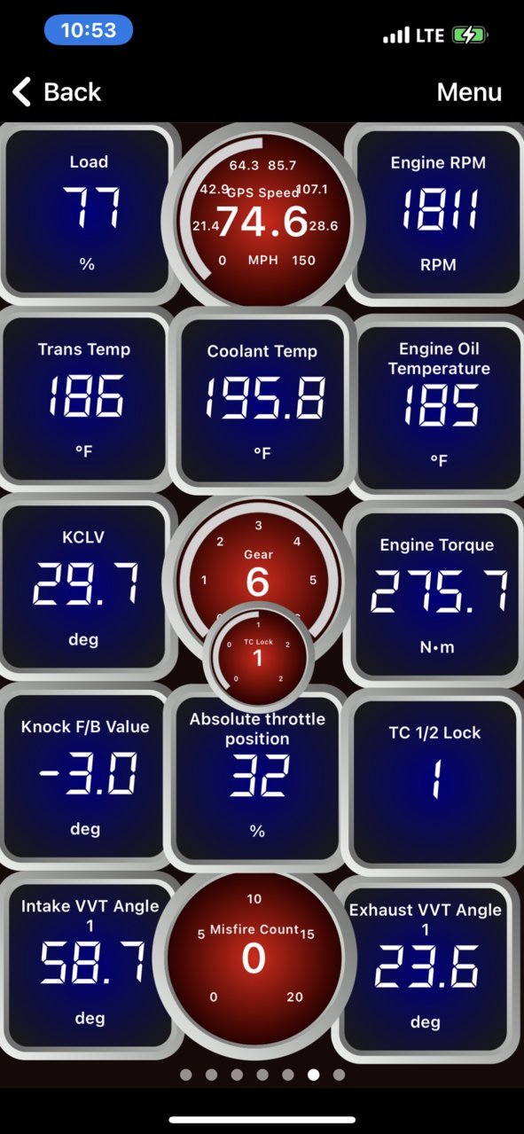

    That’s where I got it on my 2016. It works for me.
    Here’s my dashboard and a link.

    Dang, that’s what I was afraid of. I don’t have a techstream, but I’m sure it’s a different PID, that makes the most sense.

    Thanks PapaRee, that’s a great dashboard!

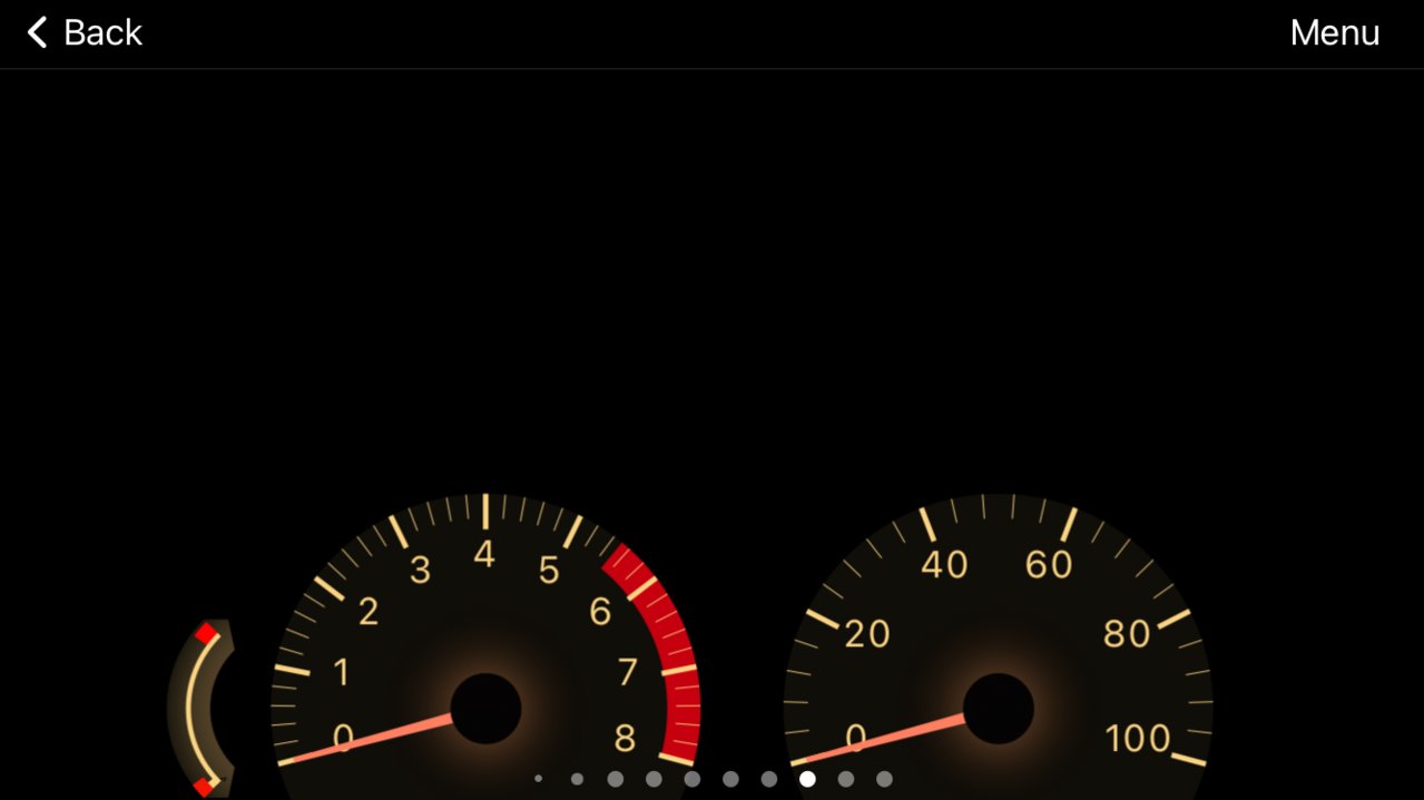

    After spending far too much time on it, it occurred to me you can stack gauges like this if you set the background of the top one to transparent (FFFFFF or 00FFFFFF). I hope this saves someone's time and frustration!
    Funny thing is I don't even need to stack them. 1st gens just don't have that many sensors, lol
    I designed a few 1st gen style dials if anyone's interested. I'll attach them here.

    Yep, stacking is a good way to optimize your screen real estate.
    fwiw, I’ve asked the developer if he would design a bar gauge (like a thermometer), those could be really efficient. Drop your voice in the bucket too if you think it has value.
