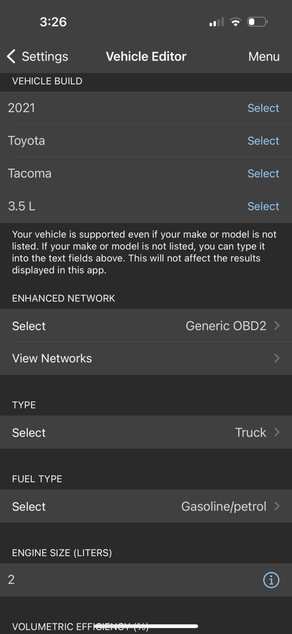

    So it ended up being under select in the Enhanced Network in the Vehicle Editor category.
    Had to change it from Prompt to Generic OBD2.

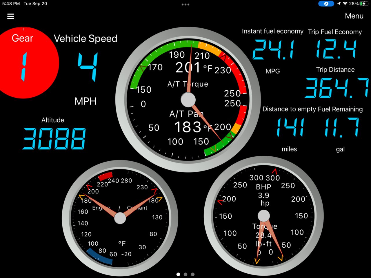

    Anyone have issues with lb.ft torque not reading correctly? Or maybe my Tacoma really is a beast… trip max reading over 300lb.ft in below photo.
    PID found in ‘Calculated PIDs’ .

    Nice use of dual gauge layout.

    There is Toyota PID in VSC control unit called Real Engine Torque. It is calculated values used in traction control. Nothing to do with the engine torque

    Which PID do you use for bhp?
  14. Jan 15, 2023 at 3:08 PM
    #414
    Vlady
    Vlady Well-Known Member
    Dec 20, 2017
    #238986
    4,628
    Issy, WA
    2017 White SR5 DCSB V6 4x4
    I don't use either. Toyota does not have PID for engine torque/power.

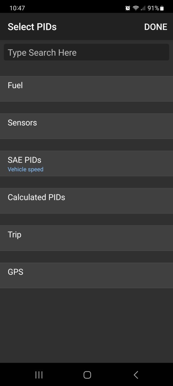

    I have Samsung Galaxy S21, Carista dongle and purchased the Fusion app along with the 2021 Toyota add on for the sole purpose of monitoring trans temp while towing. Ironically, trans temp is the one thing I cannot find to monitor. I've searched "A/T", "trans", etc and cannot find the one thing I want to monitor. Where can I find this in the app?
    I've looked through: Sensors, SAE PID's cna Calculated PID's.
    Any help is appreciated.

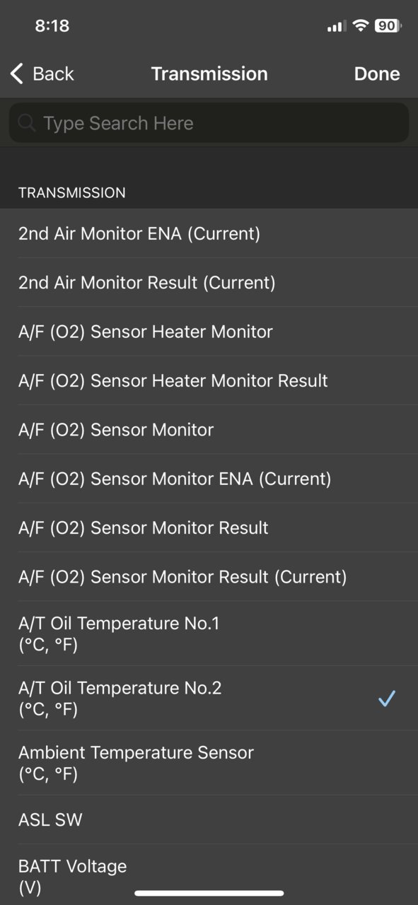

    PID
    Toyota Lexus Scion
    Network A
    Transmission

    2025 TRD OR & 2000 SR5
    I appreciate the help.
    Your OS looks different from mine.
    It's not under sensors, SAE PIDs or calculated PIDs. Does this look like the right page to be looking?
  20. Mar 12, 2023 at 8:54 AM
    #420
    rybern
    rybern Well-Known Member
    Apr 3, 2017
    #215281
    2,668
    N Alabama
    When I search for "transmission" these are the only options I see:
