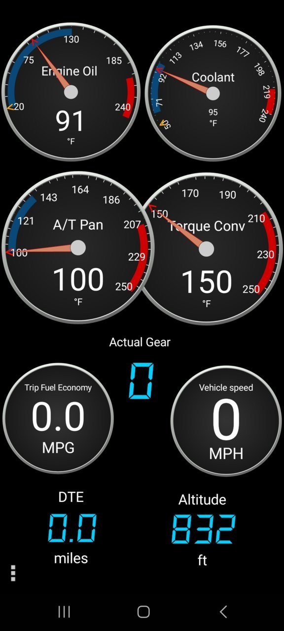

    I gotta figure that out. I'd like to add that behind gear status. Here's where I'm at so far.
    I pulled the travel trailer for the first time this weekend and I felt naked not knowing the trans temp going up a hill. I'm very grateful to have this took working. Dry weight is 3400 and likely 4000 or so loaded up.... we're light packers.

    OK, I found SLU and locking status. I'd like to create an indicator behind the gear status that shows green when locked and red when unlocked.
    What is Slu solenoid?

    Engine oil, Coolant, A/T 1(Pan), A/T 2 (T/C), Speed and Altitude all seem to work good. But I'm having issues with the following:
    1. Gear status Always shows "0", I've removed and installed it and still get same result.
    2. Lock Up Status shows black back ground a lot of the time but does show green some and red some. Here's screen shots for Lock Up Status is someone sees something wrong:

    For the gear you need the “status of the shift status” PID
