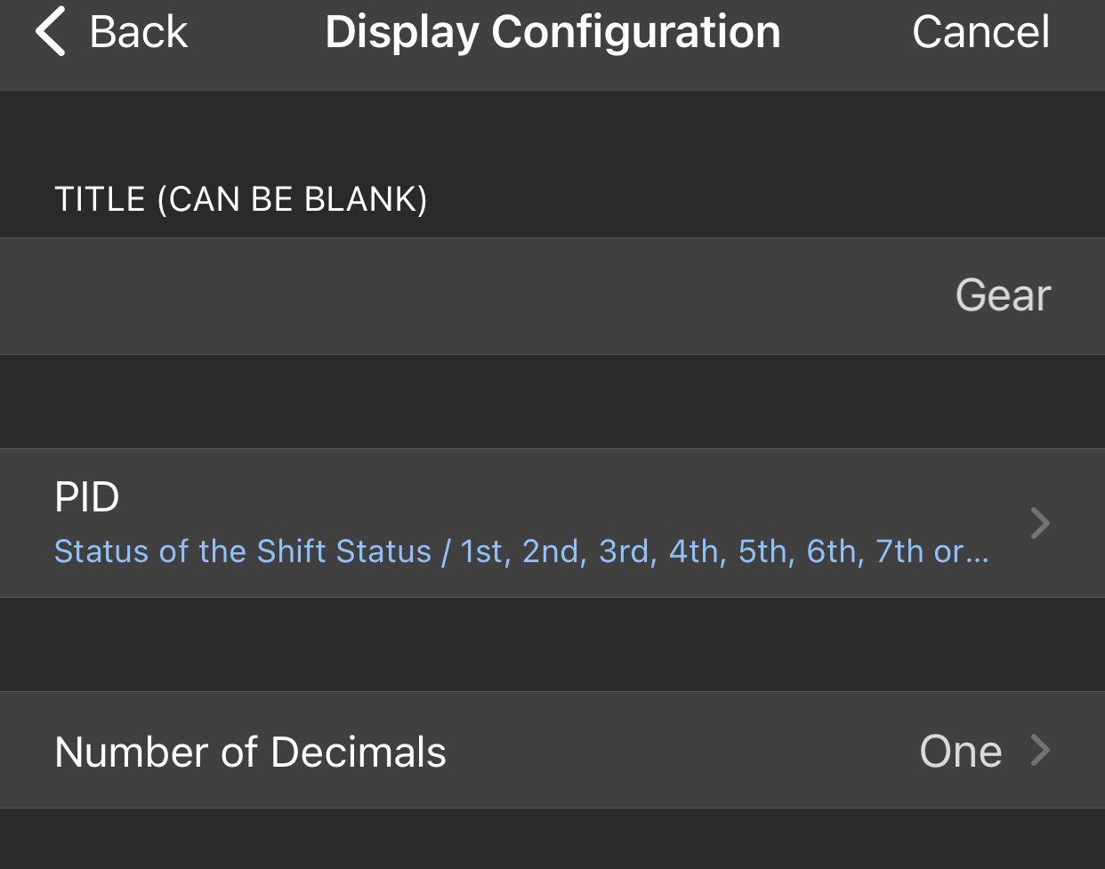

    Thanks for that. I didn't find that exact one but I've added one that's "shift status" in transmission and another that's "status of the shift info". Well see if one of those works.

    Success.
    Gear status works and lock/unlock seems to be working now.
    I appreciate everyone help.

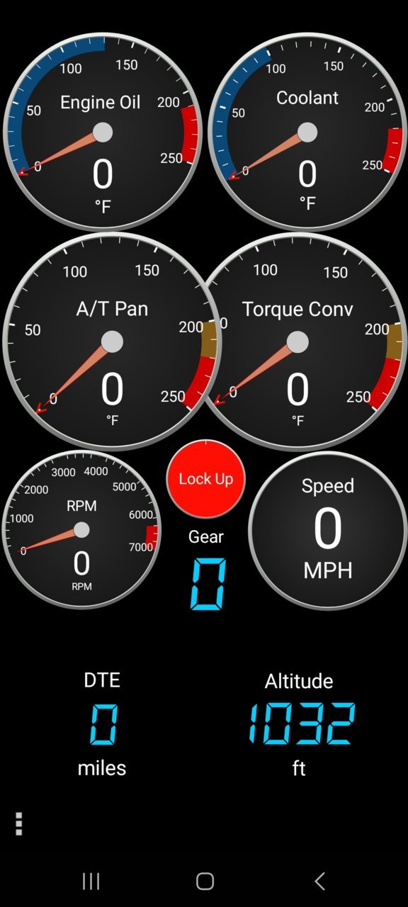

    Ah, I didn't realize thats what those did. I added them and I now see the reset "min/max". This app is VERY cool.
    I cleaned up the gauge lines, warnings, numbers, etc and added a tach. Can I chance the 1000 thru 7000 numbers to 1 thru 7?

    I believe there’s a multiplier option in the dial config.

    Ha, that fixed it. Thank you.... I feel like I owe you all some money. :thumbsup:

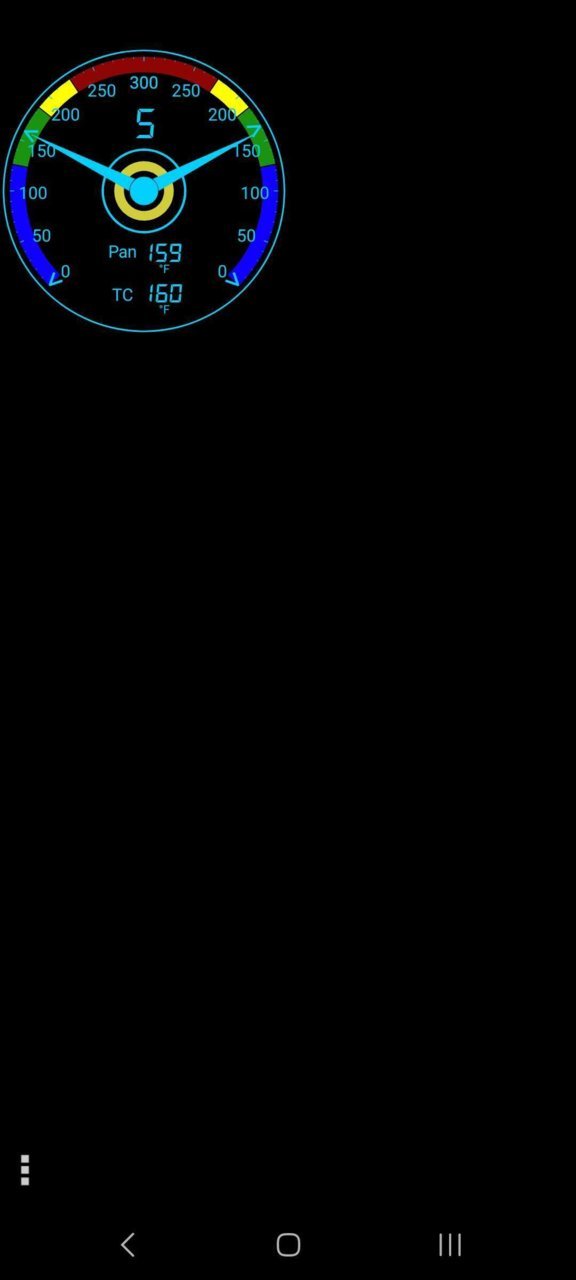

    I feel dumb, finally figured out transparencies so I can multi gauge on android. Color scheme, layout, ranges, etc are still a work in progress but the POC was a success. Yellow ring SLU, red TC Lockup. I'll probably make the pan vs tc colors slightly different for needle, text, gauge ticks

    There's a lot to this app. I've been messing with this on and off for nearly two months and still figuring things out. Nice job on the trans gauge. I kind of like the split gauge and may experiment with it so I can have an even larger gauge for the trans. I'm using my phone to display this info and it's working out great for me.

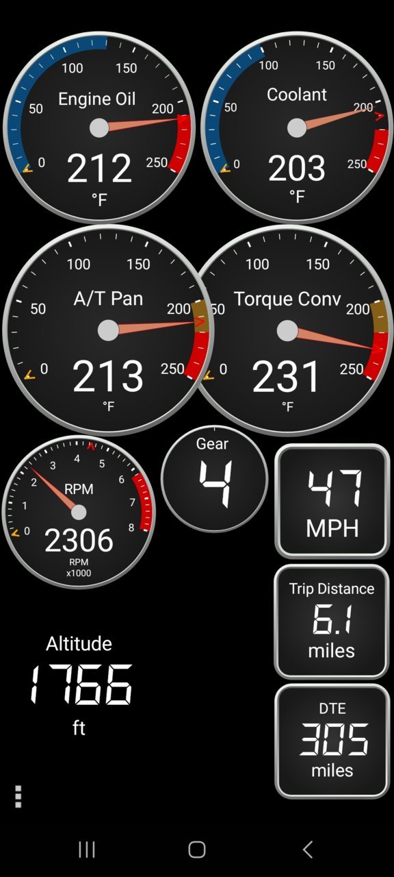

    I'd like to know too. I don't like Temps above 200 deg. I towed our 4000 lb travel trailer up a 500' in 1 mile ascend over the weekend and the TC reached 231 degrees (pan temp was 213 deg) for a few minutes until I crested the top of the mountain.
    After cresting the mountain it cooled down to 215 deg in less than half a mile once the TC locked. Normal towing temp seemed to be 185 to 190.
    He's not tuned. Will that help? I have an appointment to get KDMax next month.... it I don't tune myself before then.

    500 in a mile is steep, guessing you were in 3rd? The TC doesn’t lock in 1st, 2nd, or 3rd, if you’re in that position again drop to 2nd, get the revs high and get that fluid moving.
    186’+/- is operating temp for the transmission, if you pin the transmission pan temps whilst cruising are typically around 170’ depending on ambient temps and road conditions. In 8k miles of towing miles I’ve never had the pan temp get over 200’.

    I have my Fusion dashboard set up like you do the gear selector shows lock up status as red or green warnings but there are times it doesn't display either.
    What's PNW?
    I pretty much always in S4 when I was towing. But being in S4 doesn't seem to always keep the TC locked in 4th(even after the shift is complete).
    I don't think my dashboard is currently monitoring SLU.... but only "lock up status" which is supposed to display red or green warning behind the gear status.
