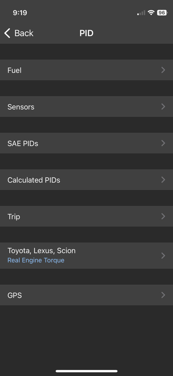

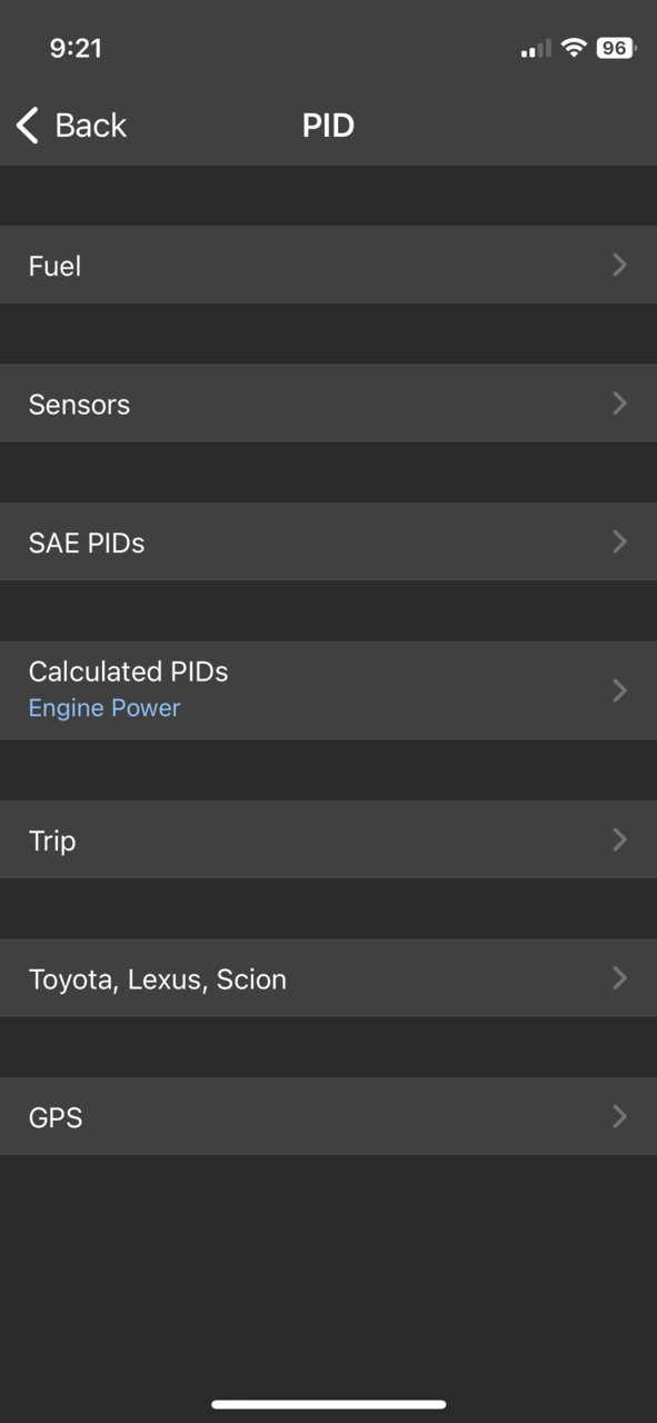

    Here is how I got those two.
    boston23[QUOTED] likes this.
