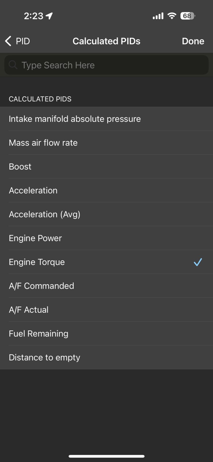

    Where do I get the HP/engine power to work? I have carista. Tia

    I think I’m using: Calculated PIDs | Engine Power.
    Torque is in there too.
    MiTacoTRD[QUOTED] likes this.
  14. Dec 9, 2023 at 12:39 PM
    #514
    MiTacoTRD
    MiTacoTRD Well-Known Member
    Aug 24, 2019
    #303129
    1,357
    N. Idaho
    2019 Tacoma TRD Off-Road DCSB
    I've tried this and still reading zero...:confused:
  15. Dec 9, 2023 at 2:24 PM
    #515
    TacoManOne
    TacoManOne YotaWerx Authorized Tuner
    Mar 10, 2018
    #246923
    1,942
    Paul
    Liberty Lake, WA
    2018 Blazing Blue TRDOR DCLB Premium JBL
    YotaWerx Tuned, Meso stuff, JBL upgrades, Bilstein 6112/5160, RAS
    These work for me. and power right above.

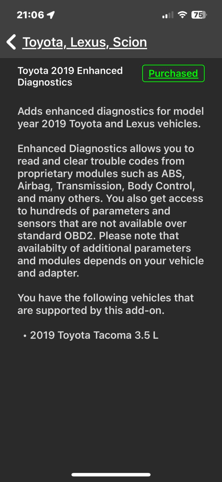

    Did you get the Toyota extended data set?
  18. Dec 9, 2023 at 9:07 PM
    #518
    MiTacoTRD
    Aug 24, 2019
    #303129
    1,357
    N. Idaho
    This one…
  19. Dec 10, 2023 at 6:56 AM
    #519
    TacoManOne
    Mar 10, 2018
    #246923
    1,942
    Paul
    Liberty Lake, WA
    That one. Yep.
  20. Dec 10, 2023 at 11:29 AM
    #520
    MiTacoTRD
    Aug 24, 2019
    #303129
    1,357
    N. Idaho
    Doesn’t work for me. I’ll delete/remove the said display and restore purchases. Then add them again.
