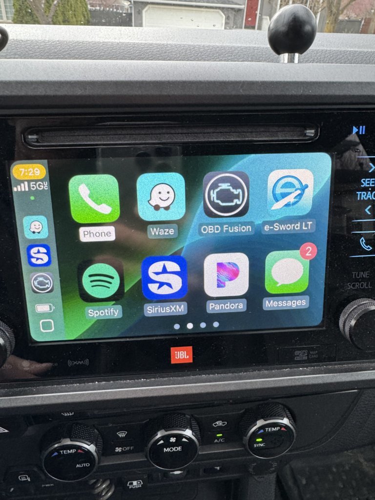

    Is anyone here running the Carsync Tech Apple CarPlay module? I installed it last night and everything seems to work correctly except OBD Fusion. I can get it to ‘connect’, it shows a disconnect option then. But I can’t seem to figure out how to display dashboards.

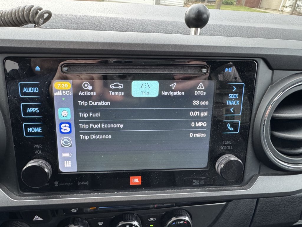

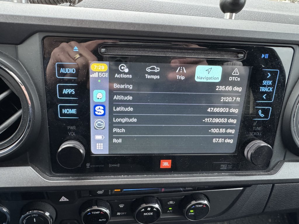

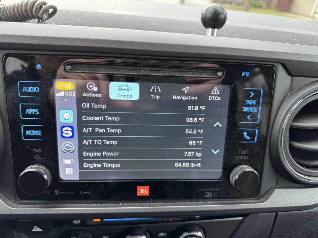

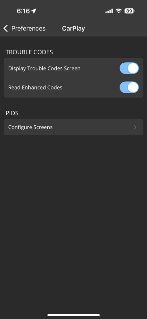

    I am. No dashboards. You have to configure screens. Shows a list of data points nothing fancy. I can get a shot of what it looks like later today Here is the setup on the iPhone
    That’s my setup. Works fine. Not as cool as a gauge but gets the numbers I need. You can add a bunch more but then you have to scroll down to see them.
